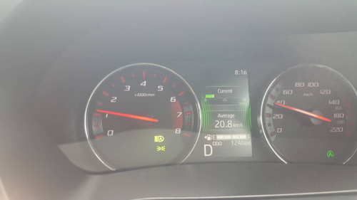

post Dec 13 2022, 02:36 PM
162 posts
Joined: Sep 2008
Yup. Smooth drive and probably save petrol too. But there is no way I can reach 21.1KM/L as claimed. I consistently getting around 20KM/L.
