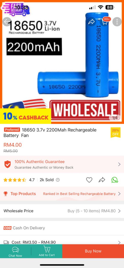

so may i replace with other capacity inr18650 battery?shope not found inr18650 2200 mah
how about others than inr? like icr ..

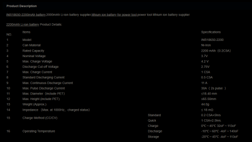

the battery pack look ...
the circuit board has 1 smd fuse which is 12A ..so high?
china 18650 should be very hard to find the datasheet ...
order same brand and capacity from taobao? local cannot find the same 18650 battery
thanks ...

11A discharge current. Just find something more that that

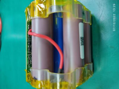

the battery wont charging ...
wonder can mix the blue colour 18650 ,not sure wat capacity ..with the others original battery pack battery ?
thanks ..
You can try, but I don't think you will get good results unless the blue battery came from a power tool battery pack. If it came from a computer battery pack, usually the discharge current is low, maybe about 3 A continuous only. So when the robot draws 8 A while working, that battery will fail. I hope I'm making sense, been a long day the brain power used up already

QUOTE(stormer.lyn @ Dec 5 2022, 08:03 PM)
the blue battery i think come from solar led light..
i just want to connect, measure voltage , then see can charge by using cordless vacuum charger ..
if everything working then will purchase same type of battery to replace all ...

connected blue battery ..getting voltage as below
(black) to (red)
B- to B1...3.56v
B1 to B2...2.97v
B2 to B3..4.0v
B3 to B4..2.89v
B4 to B+,...2.9v
after connected battery ..the bms board feeling warm ..isn't turing on ?
thanks ..

QUOTE(sgpdsmss @ Dec 7 2022, 01:31 PM)
(black) to (red)
B- to B1...3.56v
B1 to B2...2.97v
B2 to B3..4.0v
B3 to B4..2.89v
B4 to B+,...2.9v
thanks ..
When charging the BMS should be warm, as current is flowing. Only when all batteries are charged will the current drop to zero and then also the heat. I can see that the original batteries were discharged down to about 2.9 V but the new batteries you installed are at full charge. Just let it charge and see if all the battery voltages approach about 4 V. If yes, then you are okay

after connected all batterys to board ..it's start warm ..
tried to charge ..but it wont charged ..no led light up ..
could be bms board faulty ...
