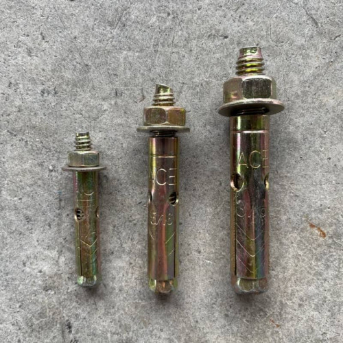

The screw quite big....
Like this screw....

this is a wall plug.

already repair the tyre liao...
the mechanic say the length around 4~5 cm....
