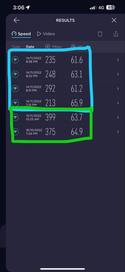

My home is using Maxis fibre 300mbps TNB infra
When I use Maxis wifi 6 router, the speed result is almost 400mbps
But when I use TP-Link archer ax50 then the speed is 200mbps
Anyone have meet the same problem?
Green color is maxis wifi 6 router and blue color is tplink router

......Disable the QOS, don't use it.
If you enable QOS, NAT acceleration will not be able to function.
