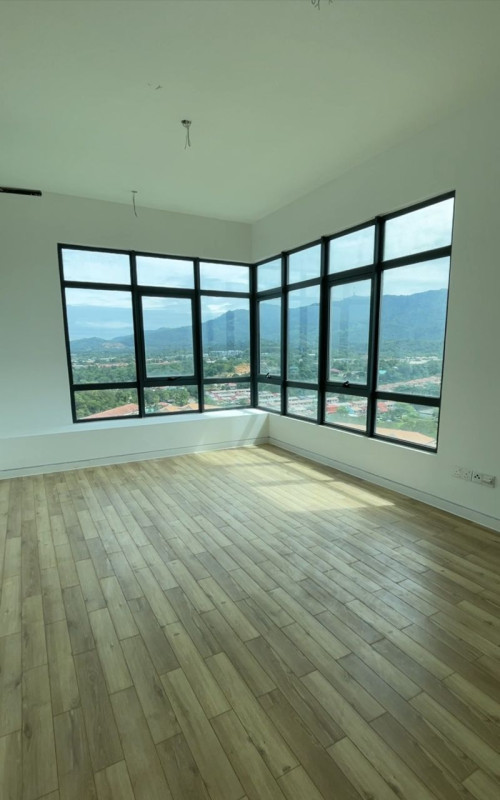

hello all, want some advice on my masterbed room heat issues. I got a very large L shape window, not sure what is the developer thinking because the view not so good also.....
I got install tint recently, but my room still feels very hot in the morning. my room temperature around 30 degree Celsius but feels way hotter than my other room that is 31 degree Celsius and only my room got this issues.
And out of all 7 casement window, only 3 can open and it is open from below for safety purpose and the gap is so small that i can hardly blow stand fan at it.
the major concern is that the heat built up so fast early morning and it just stays there till night time even after install tint. So what can i do to keep the room stays cool? blackout curtain? or any suggestion?

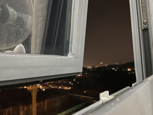

Thats a tough nut to crack. You can replace the normal tint with higher quality reflective tint, subject to your JMB rules, but its not only the windows that is the problem........ Blackout curtains is a must.
The walls will also radiate heat all night long after being heated up in the day.
What you can do is to try to cool the room down before you come back. Install a timer equipped ventilation fan in the bathroom to turn on and vent the room before you get back...so your aircon wont have to work extra hard to cool the room down. However that works best if you can leave your windows open a crack to allow for crossflow, so the vent fan can actually properly work.

QUOTE(thomasyke @ Nov 7 2022, 03:35 PM)
Try this, not kidding, there will probably be other similar videos, but what you want is to move the air either out of your room, or circulate it.
That's the point I was trying to make. Use the vent fan in the bathroom, crack open the windows, and close your bedroom door.
Your bathroom vent fan will suck out the hot built-up air through your windows and out the bathroom.
I do that with mine, at it gets hot with the evening sun. I am just too lazy to install a smart timer to control that bathroom vent fan, so I just switch it on when I get back.

QUOTE(nihility @ Nov 8 2022, 09:50 AM)
I'll go for the thermal insulated blackout curtain.
If you already have AC in the room, leave the window closed. Opening the window will cause the hot air / fresh air entering the room via the window opening.
I want to ask, what if I just cover the window and window frame with BB238FR-10 Aluminium Foil Bubble Foil? will it block the conduction heat better? or still the thermal insulated blackout curtain will be better?

QUOTE(strattos93 @ Nov 12 2022, 03:20 PM)
It will help if based on the technical specification.

QUOTE(nihility @ Nov 12 2022, 05:08 PM)
i see, then is it that i need to install/paste like 2 cm from the window frame to get the best result for radiant heat reject?
