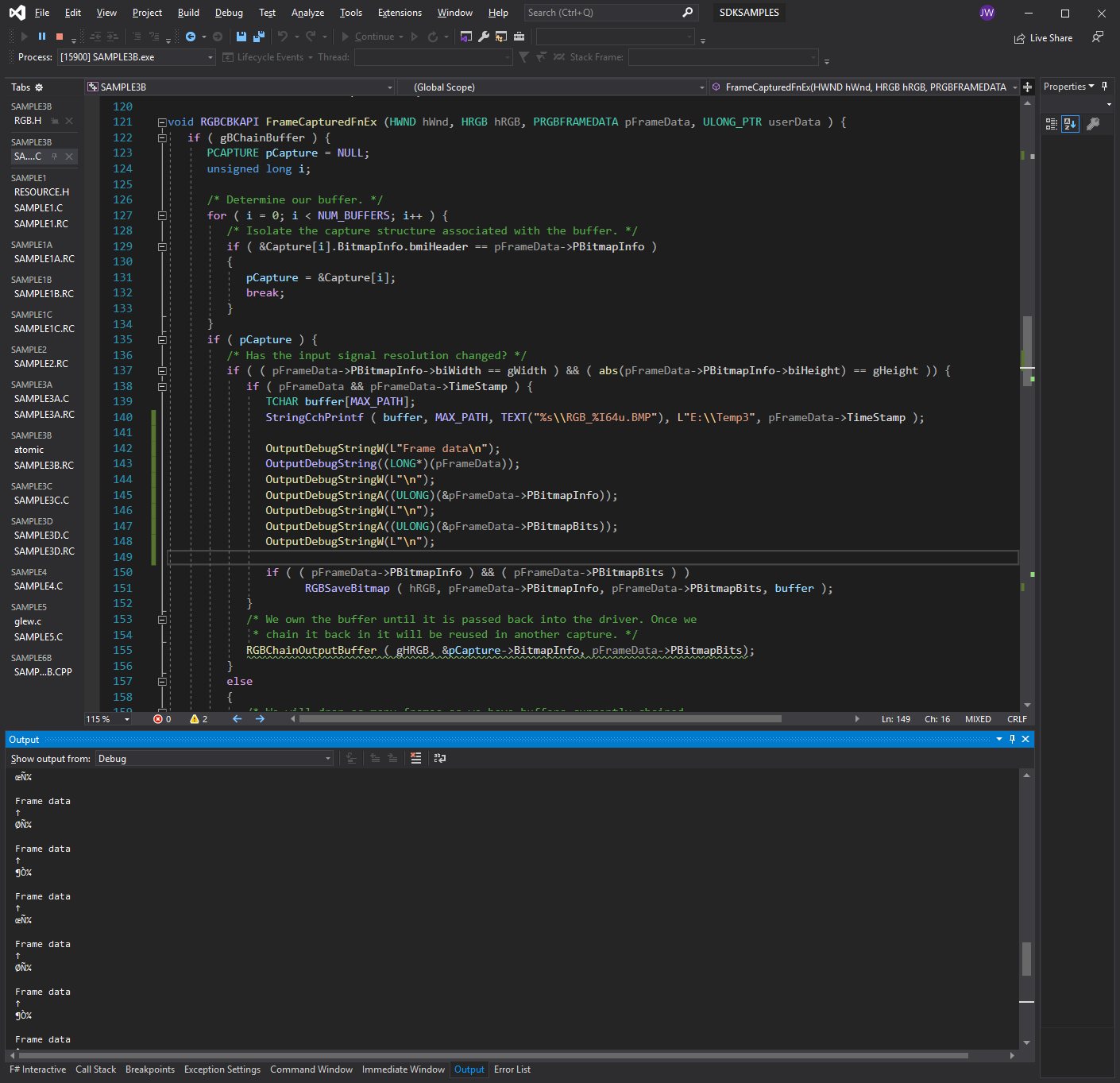

I want to print out the value of 2nd and 3rd parameters for the line number 151
They supposed to be address, but im not able to display them, look at the output window, how do i properly display them ?

QUOTE(narf03 @ Nov 6 2022, 04:13 AM)
Looks like OutputDebugStringA merely prints string (without format specifier available). To display memory address, you have to convert it to hexadecimal numbers.

QUOTE(FlierMate11 @ Nov 6 2022, 05:16 AM)
For example in C:
CODE
printf("%x\r\n",&pbmpinf);
actually i tried printf, nothing visible(no error either).

QUOTE(narf03 @ Nov 6 2022, 05:26 AM)
Try this,
sprintf(stderr, "%x\r\n",&pbmpinf);
Alternative longer,
char szMsg[32];
snprintf(szMsg, sizeof(szMsg), "%x\r\n",&pbmpinf);
OutputDebugStringA (szMsg);

To get the address of that PBitmapInfo, have you try
CODE
&(pFrameData->PBitmapInfo)
, rather than
CODE
&pFrameData->PBitmapInfo
I haven't touch C++ for more than a decade, I might have got the operator precedence wrongly.

What's the definition of PBitmapInfo and PBitmapBits? If these are addresses (or pointers), then you should use be using printf("%x", pFrameData->PBitmapInfo).
Using &pFrameData->PBitmapInfo would mean, "address of pFrameData->PBitmapInfo", i.e. address of an address.
*pFrameData->PBitmapInfo would then be "content of pFrameData->PBitmapInfo".
Or just save your headache and use a debugger, put a breakpoint on that line, and see the value in memory.

QUOTE(Find The Way @ Nov 8 2022, 04:06 PM)
CODE
, rather than
CODE
Ignore my last comment. Google result shows -> indeed has higher precedence than &.
