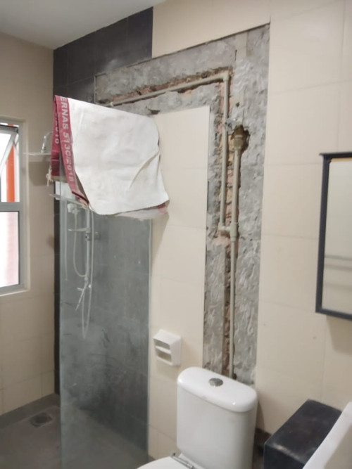

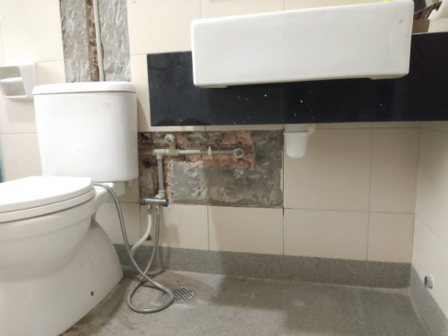

Hi all,
My bathroom water pipe leaking internally so have to hack the wall and replace new one.. Was thinking any other solid materials beside those grey colored pipe which tends to break after some years?
Is there anyone who uses ss piping / aluminium piping and conceal them for long lasting use?

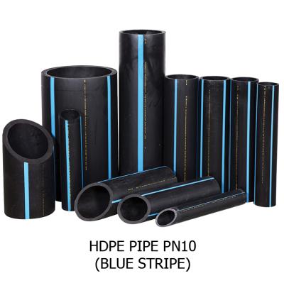

HDPE pipes because they are used out in the open and are proven to be resilient.
stormer.lyn
post Oct 6 2022, 09:11 AM
1,132 posts
Joined: Apr 2014
From: Shah Alam, Selangor
QUOTE(BrunoMalaya @ Oct 6 2022, 01:48 AM)
I agree, but please choose pipe that conforms to SIRIM standard if plumbing a bathroom with buried pipes. I believe that means the pipes will be rated PN12.5 or above.
(PN = Maximum pressure rating, in Bar. 1 Bar ≈ 14.5 psi)
Pressure rating depends on the thickness of the pipe walls, which in turn determines if the joint fittings fit and seal well without leaking or not.
TSshinchan99

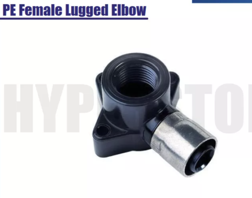

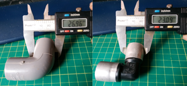

I think HDPE pipe is suitable to be concealed.
1. The pipes are slightly smaller than the equivalent PVC pipe.
2. The joints are smaller than PVC joints.
3. You can get straight pipes in lengths of 4 5 m, or go for a whole 100 m roll.
4. There are suitable mounted threaded connectors to fix your taps
5. The pipe is flexible, so will absorb slight wall movement or foundation settling
6. Water hammer noise is reduced
7. Available with pressure ratings up to PN20
8. Easy to work with, no solvent, joints are immediate.
It's not a perfect system though. Bad points are :
1. You need special crimpers. Each size is ~RM 210 - RM 300, usually 3 crimpers needed
2. You can't joint close to the wall/edge, as you minimum need the space for the crimper to make the joint
3. Not everyone can install due to the requirements of tools
4. I don't think it is prohibitively expensive, but it is more expensive than PVC
(Example of the elbow joints in the picture above.... PVC cost RM 0.60 , HDPE cost RM 2.40)
5. For wet areas the aluminium part of the joints need protection with self sealing tape
Full disclosure : I am not a plumber. But I am doing up my own place by myself as a "hobby" project. I have pressure tested the HDPE pipes I installed to 150 psi and all looks good. (Bought the crimpers and a pressure pump) I do help out friends and family who have plumbing problems, and I always use HDPE when I can. So far none of the things I have done have failed, but who knows 10 years down the line. The above points are strictly my experience using HDPE pipe for plumbing, and does not constitute an endorsement or a recommendation. YMMV.
This post has been edited by stormer.lyn: Oct 7 2022, 10:46 PM

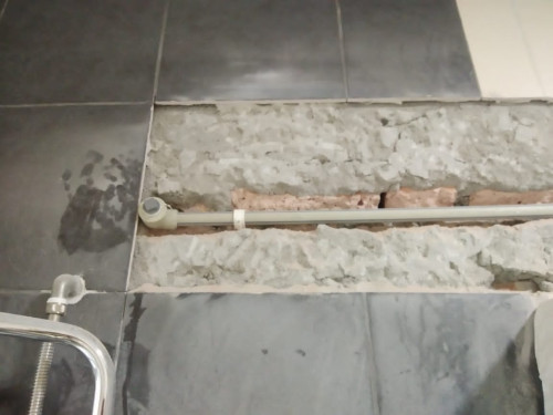

TSshinchan99
post Oct 11 2022, 02:04 PM
619 posts
Joined: Feb 2005
I think hardly any contractor out there who will be using these kind of pipes.. most that I came across are those that uses pvc and those black ones..
I don't mind paying extra for those hdpe if they are long lasting in concealed setup.. do share me contacts if there are those who willing to use these pipes..
the usual black pipes I saw them use doesn't have these kind of connectors as showed by @stormer.lyn

If you don't want scale to form up on the internal surface of the pipe, avoid the G.I or copper pipe.
Go for plastic pipe. Plastic pipe - HDPE, PPR & PVC are widely used. PPR is gaining popularity recently.
For HDPE, the fitting for "T" & elbow are 1 size smaller, if you have multiple bend or joints, be cautious because that will cause a significant pressure drop. A lot brand have HDPE product - Sansico (Hansen) , Kindraco, BBB, etc .
Avoid ABS at all cost. ABS , after a few year, leaking will start to appear. Even most of the manufacturers already gave up the ABS product.

QUOTE(nihility @ Oct 12 2022, 08:04 AM)
I 100% agree with you. I just want to point out that the pressure does not drop, the flow rate does. After all, 3 bar through a straw is the same as 3 bar through a 20 mm pipe. But you wouldn't be satisfied with a shower with the water coming from that straw.
I notice that piping in M'sia is done without any concept of water flow rate. One small pipe branches off to 2 small pipes, or an entire bathroom is fed by a small pipe. No wonder as soon as you turn on a tap, the shower water slows. And then to get a better flow rate, add on a booster pump, and set the pump to high pressure. No wonder everything starts leaking after some time.
Just think of a bucket of water dumped on your head, versus that same bucket hanging over your head with just a small hole dribbling water. Which would you rather bathe in?
My conclusion is that water supply pipes should be well designed also, with as few turns as possible, and with proper sizing in mind, no matter what type of material is used.

Found a contractor doing my current leaking, they gave me PPR pipe, joints are heated instead of glued..
Are these lasting?

QUOTE(shinchan99 @ Oct 28 2022, 10:27 AM)
Are these lasting?
cgamer
post Oct 29 2022, 07:33 AM
81 posts
Joined: Nov 2006
QUOTE(mini orchard @ Oct 28 2022, 10:54 AM)
Ya, definitely last longer if they joint correctly . Ask them do a leak check before done. Theoretically, if using cold water indoor it can last longer 30 years and more. Just one thing PPR cannot stand more than 50’c or 60’c water.
