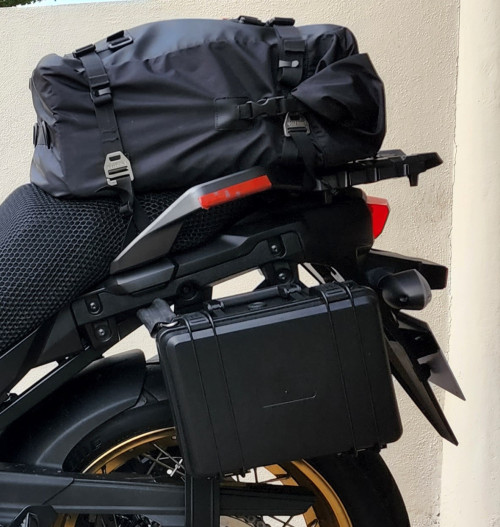

I learned to travel light during my bicycle touring days. Thus I only need a 30 liter Uglybros tail bag and a hard case tool box. I have another Uglybros 20 liter bag to add if I need more space.

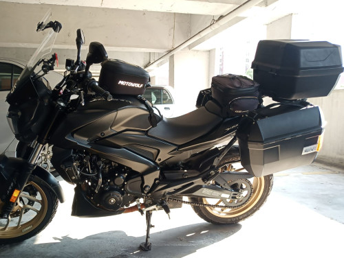

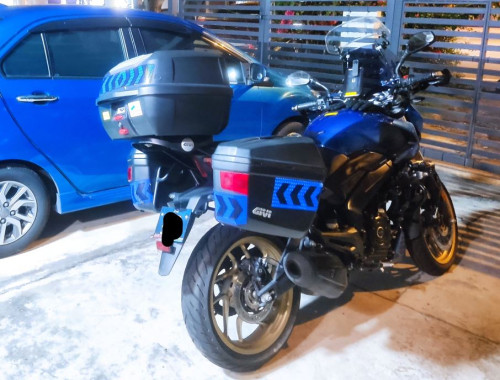

I am now using GIVI E23 side panniers. they are much heavier (with the addition to the racks) but they are weather sealed and easier to get on and off. It also doubles as my chair and table when camping.
which ever setup, its enough for a few days camping trip, so touring on it is no problem. Learnt to pack light from bicycling days also. Besides, last thing you want is to go off road with an overloaded bike.

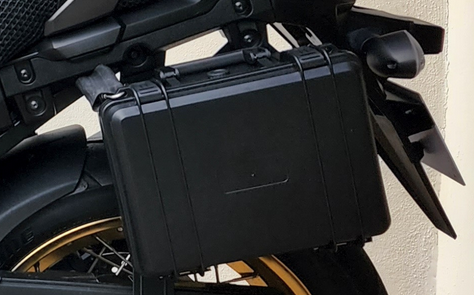

btw.. what do you call this "suitcase"/side box?
gataddhin
post Sep 29 2022, 06:11 AM
10 posts
Joined: Jul 2011
Protective Equipment Case with Sponge Hard Flight Carry Case
https://shopee.com.my/product/10203467/6834...10-1664399619.9
Or you can consider this
Rhinowalk motorcycle bag
https://a.aliexpress.com/_msjK8JI

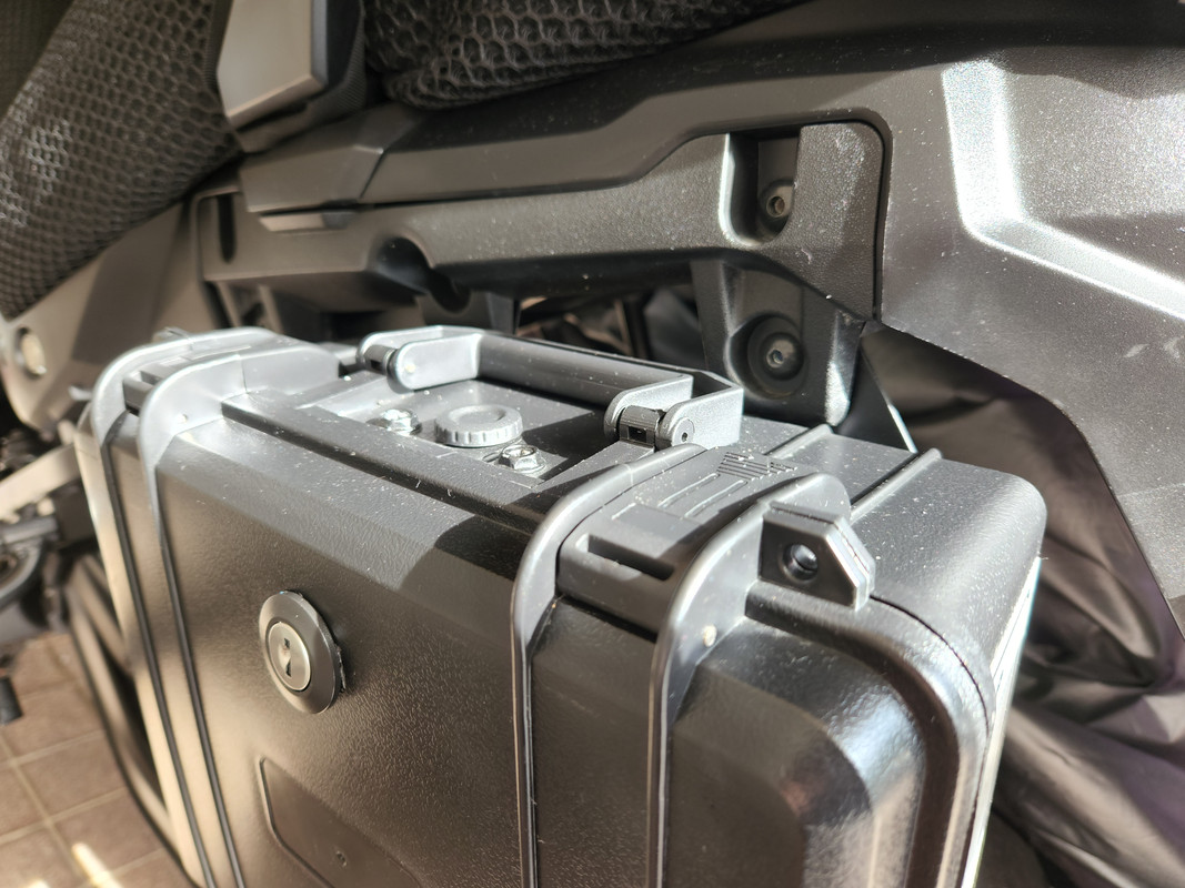

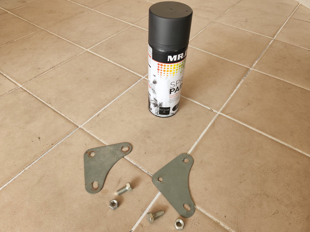

Sorry for being lengthy, but how do you secure the flight carry case to the bike?

First I sprayed matt black paint to the metal plates, bolts and nuts. Drilled 2 holes on the back of the case. Connected the case with metal plates to the existing rack mount.

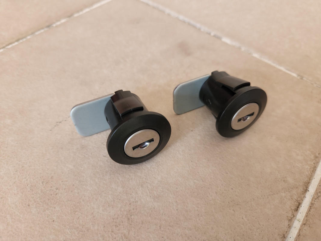

Later I made a lock on the case. My bike came with free 3-piece lock set for mounting and locking one aluminum top case and two aluminum side cases. My ignition key can open all 3 locks.

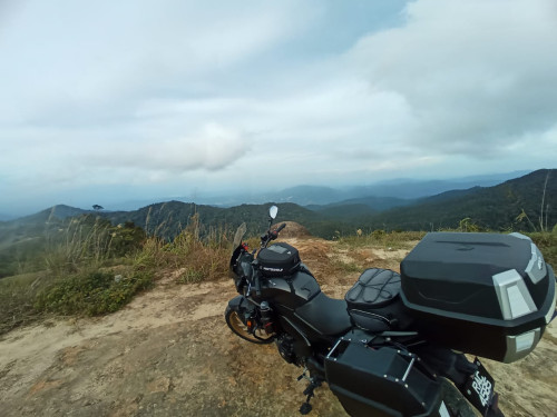

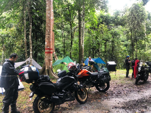

Anyway..for my touring i started off with this
And finally ended up with this

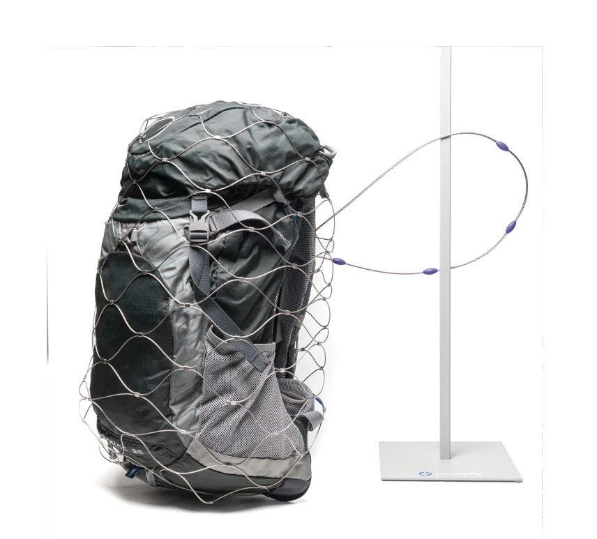

For security for my tail bag, I bought a used Anti Thief Pacsafe. (RM100). Yet to use it. So far, I used a bicycle cable lock wrapped around the tail bag when I was having my lunch across the road in Betong.
