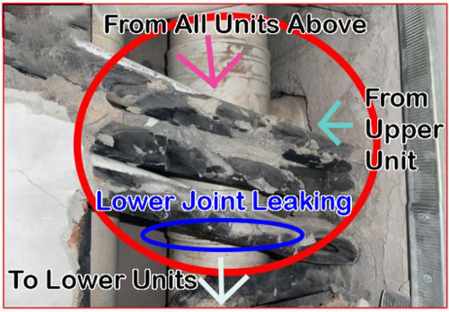

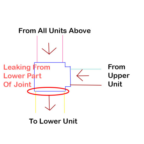

Dear all sifu, the report is provided by the management, saying that the T joint is belongs to the upper unit, so the upper unit is responsible for the repair.
Would like to seek for your professional opinion on who is responsible for the repair? Because as per the SMR 2015 no.58, the T joint does not only serve the upper unit alone, it is connected to all the units above as well. Furthermore, the T joint is leaking on the lower part and the T joint is located in the void area of lower unit.
58. Matters to be considered in determining cause of leakage
In determining the cause and the party responsible to rectify any defect, the following matters shall be taken into consideration-
(a) the presumption under section 142 of the Act that the defect is within the parcel above the affected parcel;
© any defect in any water meter, water pipe, drainage pipe, sewerage pipe, gas meter, gas pipe and duct that serves only one parcel is a defect of that parcel, even though the water meter, water pipe, drainage pipe, sewerage pipe, gas meter, gas pipe and duct may be situated on or embedded in common property or void space above the ceiling or wall or floor, as the case may be

The pipe is in void area of the lower unit

From what you draw. That leaking piece is actually touching upper and lower unit right?
Both have to pay half half? Hv he agree with tht?

The pipe is conceal in the void area of the lower unit behind the wardrobe, they hacked up the wall only found the leak from the T joint (lower part of T joint)
The leaking T joint has 3 connections, it is connected all units above(top), upper unit(right) and lower unit (btm)
The management attempt to claim for insurance first, so the upper and lower unit will wait for the result. However, was told by the management the insurance will not cover the cost for hacking to identify the leak.
This post has been edited by mrkeann: Sep 24 2022, 02:46 AM

Management came out the report state that upper unit responsible. The T joint purpose is to join the upper drain pipe to the common drain pipe, but still the T joint serve more than 1 units

As per the law the T joint serve more than 1 unit, so is upper unit really responsible?

The purpose of any joints in a discharge pipe is to connect to a user that need the waste discharge or to extend the pipe due to the limited length.
In this case, on the assumption if owner dont need the connection, the T-Joint is not necessary and the developer would just use a straight pipe without joint and there would be no leak.
If at all a straight joint is required to extend the length from upper units and if is leaking, then is the mc or jmb responsibility since it is not link to the immediate upper unit.
In conclusion, the T-Joint is to serve immediate upper unit rather than ALL upper units and hence the immediate upper unit is the 'owner'.
The above reasoning is likely the same approach taken by the insurance co and hence they rejected the claim.
In any insurance claim, the aggrieved party must prove that the fault is the insured party (ie the building management) that caused the damaged or injury for the claim to be approved.
