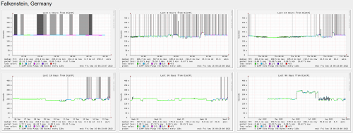

Routing issue.
IPv4
Smokeping Link for Hetzner: http://smokeping.mywebping.com/smokeping/s...ousHost.Hetzner (Just added IPv6 for hetzner)
