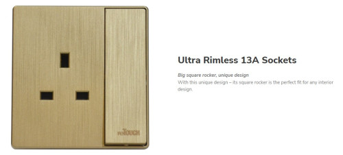

 Socket 13A, which brand to buy?
TS5igzag
post Sep 4 2022, 02:06 PM, updated 4y ago
65 posts
Joined: Feb 2021
Sockets in home looks too plain, bored of those white colour plastic.
Planning to buy some with nicer look, with the look of steel in silver/gray/gold colour.
Any brand recommendation from anyone?
I saw this one from ReTouch, looks nice, and price is affordable too, RM10+
Anyone using ReTouch sockets, and is the build quality good?
zuozi
post Sep 4 2022, 02:30 PM
1,266 posts
Joined: Oct 2009
You can visit electrical hardware shop, lightning shop to test
Build quality just looking front panel doesn't tell the whole story you need look at the back the build quality thickness, weight and the clicking noise can tell the whole story
Also need to check behind the wall how deep, how many wiring already there how thick is your existing wiring are
If the switch too thick unable to fit properly due to those wiring obstacle
If can Just visit physical shop to test around ☺️

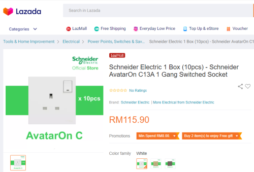

TS5igzag
post Sep 6 2022, 09:04 AM
65 posts
Joined: Feb 2021
QUOTE(ZeneticX @ Sep 4 2022, 02:57 PM)
Can consider Schneider Electric AvatarOn series as well
thumbup.gif this brand is good. and many customization options also.
problem is not much information online on its pricing.
I saw from Lazada that the simple white one costs RM30
https://www.lazada.com.my/products/schneide...4939134806.html
Dilemma over whether it's overpriced, or worth it for better quality.

GravityFi3ld
post Sep 13 2022, 03:15 PM
Nick Fury's Night Fury
912 posts
Joined: Mar 2011
From: Infinity & Beyond
QUOTE(5igzag @ Sep 6 2022, 09:04 AM)
depends on the range/model, there's really simple/basic units that are below RM10per unit, the more fancy pancy looking ones will certainly cost more laugh.gif
Also from lazada, Schneider's official store (Lazada link HERE)
My 2 cents, get the basic ones if the location of the switch/points are going to be hidden/obstructed from plain-view (like those "hidden" in the TV console) - only get the fancy pancy "designer"-vibes ones for areas you (and your guests) tend to see it more prominently smile.gif
TS5igzag
post Sep 14 2022, 08:22 AM
65 posts
Joined: Feb 2021
QUOTE(Max @ Sep 6 2022, 09:51 AM)
For normal plug usage, less on/off, not high power load, can use nice² one.
But for frequently on/off, high load (especially kitchen) use quality normal one better. If spoit, can easily/ cheap replaced.
Anyway, thats how i do. Coz high power kitchen usage that socket can broke easily especially the switch.
good point of view. I always thought high load/ heavy use one requires more expensive socket.
Things sure broke down more easily compared to my grandparent days.
TS5igzag
post Sep 14 2022, 08:25 AM
65 posts
Joined: Feb 2021
QUOTE(GravityFi3ld @ Sep 13 2022, 03:15 PM)
yeah, designer ones is much more expensive.
feel pain if using them for whole house
