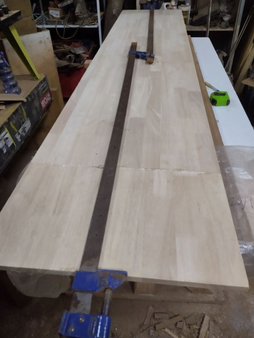

target panel is over 8ft tall.. so we have to join 2 pieces of rubberwood FJB to be able to extend to the required length/height

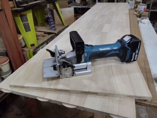

cant just butt join and glue, need joinery, easiest is biscuit or domino or dowels. (biscuit machine shown in pic)
after glueing, we clamp them, most of my clamps 4-5-6ft..so we use two 5ft clamps to become one long 9ft clamp.

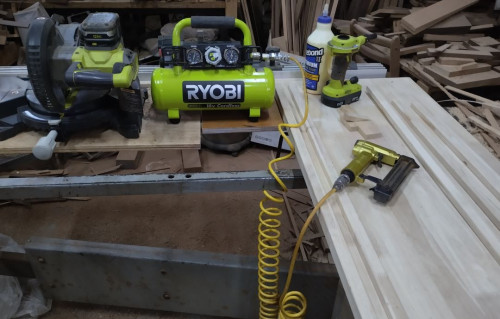

then use 23gauge pin nailer to secure in position (with glue of course), narrow 1inch strips of rubberwood wont stay straight so, u will have to figure out what to do to align them parallel.

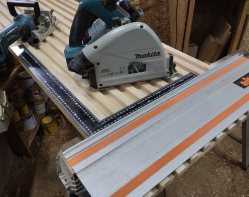

after its all done, time to trim the ends off.. track saw makes quick work. 2-3mins of positioning of the track, 10seconds of cutting, its done.

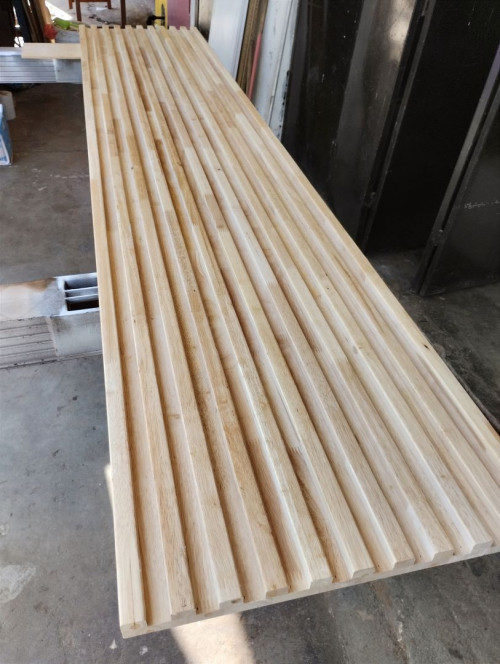

then sand and sand... rubberwood very alot of bulu2...crazy alot..
move over to spray finishing. then settled. and send over to the contractors to do the installation and fitting.
