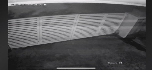

Your RG cable currently on SDI have interference problem?

QUOTE(adamw @ Sep 4 2022, 06:29 PM)
Yep, seems to have banding issue as well banding flicker.

QUOTE(nyunyu @ Sep 4 2022, 09:39 PM)
SDI very high requirements on cable, if used EOC should be ok. I have a customer factory also using SDI & once switch to IP settled. I actually fixed 2 IP camera via one coax.
