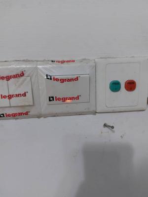

Hi all, i called a contractor to come to my house for renovation. my problem here is wiring.
he said my house air cond point is "not a proper point". Need to "re-pull" the new points to the main swicth outside the house (sorry as I do not know the jargon or the terms for house renovation. hope you guys understand).
So, he said need to add "new points" and the charges are base on the number of points. But, my house ady got existing points for air cond. I know air cond point is stronger current with "red colour thingy light". I know if i wanna install a air cond on my dining area, i need the point as there is non!.
But this contractor say my whole house points are "improper"and need to change everything and "re-pull to the outside main switch.
Im not sure wether what he say is correct and I just noob.
or he wanna earn more by suggesting me to change this and that?
pictures as attached and kindly enlighten me if im just noob. sweat.gif sweat.gif

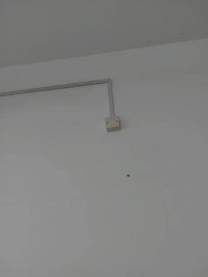

Edited : add the pictures where the air cond is use last time.

all the points with these "red colour light"on the wall.

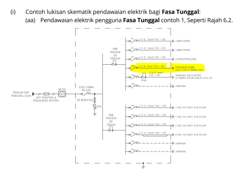

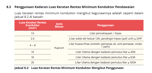

QUOTE(davidlow7 @ Aug 14 2022, 10:09 PM)
1. AC point Should be a dedicated wire directly to MCB connected to a 20A switch - wire size should be 4mm now according to ST guideline.
This is the specifications from the ST wiring guidelines you linked to in another thread. As you can see, air cond units of 2 HP (or below) are allowed 2.5 mm² wiring
Edit: link to the ST document https://www.st.gov.my/en/contents/files/dow...N_DOMESTIK1.pdf page 29
This post has been edited by stormer.lyn: Aug 15 2022, 08:15 AM

QUOTE(stormer.lyn @ Aug 15 2022, 08:11 AM)
It is allowed but if you are buying a house from the developer now they should be fitting with a 4mm regardless of what - also considering if you are pulling a new wire why not just go for 4mm straight as you will not be straining the wire too much if you on your aircon for far too long hours - also for those who frequently setting the temperature low (than what the ac can actually deliver) would be straining the wire for too many hours as the compressor would not stop. This is the reason why government had changed in this 2021 rule. THis has not factored in the wire quality used by the electrician - which to me the minimum should be Caramay or Mega.

Its a subsale house. Got tenant who live before. the wire you see in the pictures are actually got air cond last time. when the tenant move out, he take the air cond away.
now my question is why the contractor say all the points "are improper"and want me to "pull"the new points?
