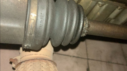

Left drive shaft is pretty new, used only 2 years with less 30,000km mileage. This week I noticed the outer rubber boot has failed. It looked recent, which I'm certain no longer than 2 weeks because I replaced the brakes 2 weeks ago.
Should I replace the whole thing or just have it fixed by replacing the rubber boot? Regrease and new rubber boot probably RM80 include labor. New part is RM170 not including labor.

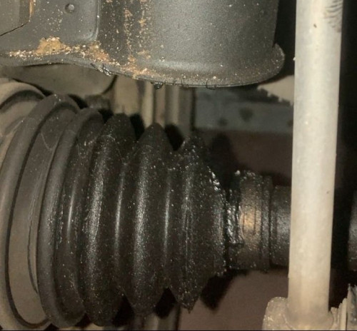

Now on the right drive shaft, it looked pretty okay. Inner rubber boot shows some crack, with grease seeping on the edge. Nothing catastrophic. This is the original part from 2007.
Any advice is greatly appreciated.

Left driveshaft is ori? If ori just replace the rubber boot. I will last very very long. Make sure no sound whatsoever when full turning.

Replace the left side and repair the factory original right side, how does that sound? But I'm curious about the wear and tear inside after 15 years and 200,000km.
