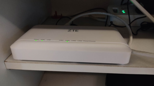

Hi, i recently subcribe Astro Fiber 500mbps but never get 500mbps. Max can i get is 450mbps which is over 80% of the speed.
My wifi can connect for wifi 5 (800mbps) i have search that wifi is half duplex so 400mbps is good as far as i know.
i tried to connect with LAN direct with PC but only connected at 100mb (my router and network card is gigabit) using cat 5e cable
how to get 1gb? using cat 6 will help or not?
one more, how to access modem from astro fiber (maybe TM unifi modem)
thank

QUOTE(rock_world @ Aug 11 2022, 08:43 PM)
Use a new Ethernet cable, preferably CAT6 or CAT7
Why?

Try connecting your PC/laptop directly to the modem using Ethernet & enter the router IP on a webpage - can refer the IP address from the back of the device.

QUOTE(TW_tankengine95 @ Aug 12 2022, 11:52 AM)
i have tried but no ip on the back of the device
it connected to unidentified network, if i know the ip, i can set it manually

QUOTE(rock_world @ Aug 12 2022, 07:18 PM)
u need to assign your own ip 1st & very likely the modem dhcp is not enabled.
very obvious you're not expert in all these & better u google more or leave them alone.

open cmd type ipconfig and then enter. Take a look at default gateway ( make sure u are connected via wifi or lan to the router). Thats the ip u enter to get into the router interface to change wifi settings. Now u need the password which be from technician or the router box, depending on brands and modification of ISP .

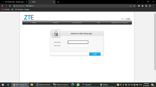

QUOTE(akhito @ Aug 14 2022, 08:19 AM)
thanks...i managed to access astro fiber modem (Modem by TM) using default ip adress and tmadmin username
there were no so much setting, u only need PON SN password

QUOTE(rock_world @ Aug 18 2022, 09:36 PM)
what's a PON SN password? and were u able to make any changes in the ZTE modem (modem by tm)? icon_idea.gif hmm.gif

QUOTE(xerophyll @ Aug 27 2022, 03:45 PM)
SN already inserted by TM technician
