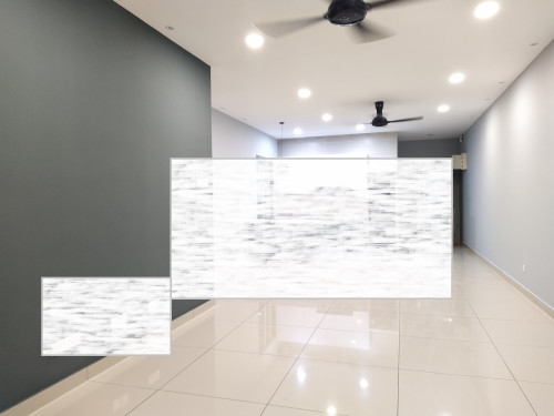

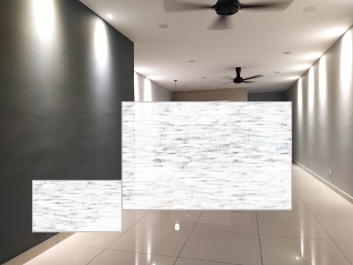

Just sharing, I have installed both downlights & eyeballs for my units. Feel free to compare.
The lights have different set of switches, so I can 'on' the lights based on my needs/feels
This post has been edited by C_ST: Aug 4 2022, 02:24 PM

QUOTE(C_ST @ Aug 4 2022, 02:23 PM)
How many watts are your downlights and eyeballs?
Will the ceiling fan create shadows when your downlights are on?
This post has been edited by ZeneticX: Aug 4 2022, 02:41 PM
C_ST
post Aug 4 2022, 03:08 PM
317 posts
Joined: Aug 2021
QUOTE(ZeneticX @ Aug 4 2022, 02:27 PM)
Downlights 18w - cool white for living & dining room, daylight for kitchen (the 2 lights far most end of the photo)
Eyeball 5w - all warm white
Maybe coz i blurred my photos. The photos are captured with fan on, and to your answer, no shadows. My contractor helped to do 'calculation & measurment' to make sure no shadow.
