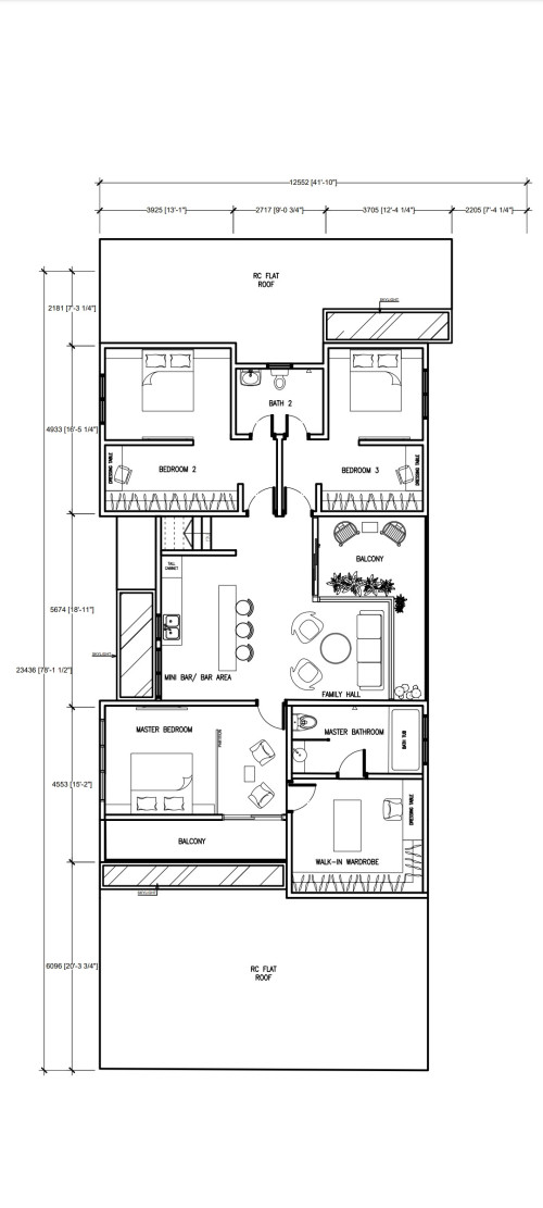

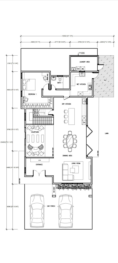

Hi, I plan to build a house from empty land. I have ID to do my layout and he told me the cost would be around 500k for the construction only not include wiring, plumping etc. Total would be 700k for all. As I have a tight budget 500k, any idea where can I reduce the cost to make it 500k for all the stuff?
https://pictr.com/images/2022/07/19/BtaDdx.md.jpg
https://pictr.com/images/2022/07/19/Bta3r8.md.jpg

Ichighost
post Jul 19 2022, 04:57 PM
358 posts
Joined: Aug 2008
From: Oxpod
QUOTE(Peach169 @ Jul 19 2022, 01:26 AM)
<a href='https://pictr.com/images/2022/07/19/BtaDdx.md.jpg' target='_blank'>https://pictr.com/images/2022/07/19/BtaDdx.md.jpg </a>
<a href='https://pictr.com/images/2022/07/19/Bta3r8.md.jpg' target='_blank'>https://pictr.com/images/2022/07/19/Bta3r8.md.jpg </a>
a few things to consider on the layout..
1. Your wet kitchen is very tight, can cosider to omit the corridor and open up the area.
2. Laundry entrace from outside is not the best way to do it. Maybe can group it together with Bath 1.
3. Bedroom 1 can reduce in size. (unless you have specific usage/person that need the space then okay lah i guess)
4. Bedroom 2 and 3 no need to have a brickwall to split between the walk in wardrobe and sleeping area. More flexibility, you can do it with other wall types.
5. Should consider to add one more toilet and do it ensuite for both Bedroom 2 and 3.
6. Should consider coming into the master bedroom, turn left you get into the walk in wardrobe and place the master bath in front (swap the position). Seating in front of sliding door in the master bedroom doesnt work, need to adjust (depending on the swap position).
