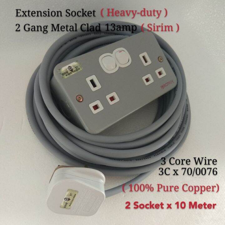

pretty23
post Jul 8 2022, 02:04 PM
1,791 posts
Joined: Jul 2011
can. Make sure the extension material is good enough.

nihility
post Jul 8 2022, 02:20 PM
1,596 posts
Joined: Sep 2021
QUOTE(pretty23 @ Jul 8 2022, 02:04 PM)
Example
Not accurate. It have yet to cover the worst case. Usually a 16A MCB will have 2 nos. of 13A SSO. Usually this 13A SSO will be installed close to each another. If the
1) 1st 13A SSO in used for the electrical kettle / oven
2) 2nd 13A SSO in used for refrigerator + the extension you use for another ( high power consumption device)
The 16A MCB will trip, if it did not trip/malfunction, the cable for this circuit will be melted /burned.
It has nothing to do on the material of extension cord. It start with the fundamental on how much ampere / kW the circuit can take from the 16A rated MCB.
