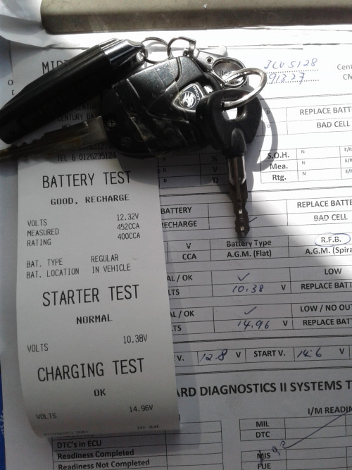

Roman Catholic
post Jun 29 2022, 10:36 PM
3,520 posts
Joined: Feb 2017
Correct an old weak battery can cause the engine to stall. Systems Test are meant to check if the electrical charging systems are ok. If there are not ok, that will create problems for the battery too.
Example B&ST would be like this ...

QUOTE(Roman Catholic @ Jun 29 2022, 10:36 PM)
Makes sense.
Come to think of it, electrical stuff isn't exactly the mechanic strong suit. Never saw him hold an OBD tool. I think I have reason to doubt his word saying that the battery and alternator is good.
Where to do this test? Battery shop?

QUOTE(Steponlego @ Jun 29 2022, 10:40 PM)
Makes sense.
Perodua Service Centers would have better diagnostic tool. Alternatively you can check with your local battery reseller if they can do B&ST for you.

Yep recently they do battery test and tayar check also as part of std service package, they kasi slip lepas habis service. Really helps to better predict the time to replace batts.
