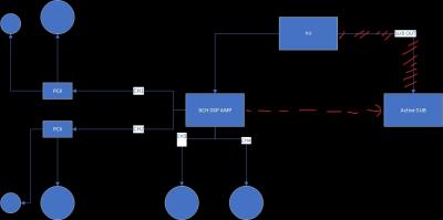

Greetings,
my current setup as in the picture.
i want to do time alignment from the amp but the sub is not connected to it.
amp doesnt have RCA output.
any sugestion how to connect the active sub?
LOC can use in this setup?
Thanks,
