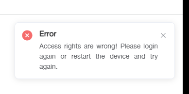

As the title says i was unable to login into my FiberHome Wifi6 router. Couple of days ago everything work fine and yesterday i login to add a new port forwarding rule. The router accept the new entry and suddenly the wifi stop working. I attempt to login back to check what went wrong but the login page keep refuse me. There is an error say "Access rights are wrong! Please login again or restart the device and try again". I have try everything turn off/on, reset the router login as superadmin, nothing works. The router let me login, show me the UI and the kick me out in seconds with the said warning.
Any advise is highly appreciated. Thanks.

I also got the same problem on my fiberhome sr1041. Tried googling this and got here. After troubleshooting for a while, I finally got back to login normally. The answer: new password.
If this happens to you, I hope you have the router settings saved and backed up before. If this is your main router and you don't have backup settings then you might have to call unifi to get the pppoe username and password.
Just factory reset the router by pushing the reset button for like 5 seconds. Then login into the web UI. You should see the router asking for the default(I think the original password the router came with) and new password. DO NOT USE the password you use last time for this new password (I think this is what is causing the problem even after resetting the router many times). Then just complete the setup or skip them all and go to login page again. You should be able to login as usual with the new password.
