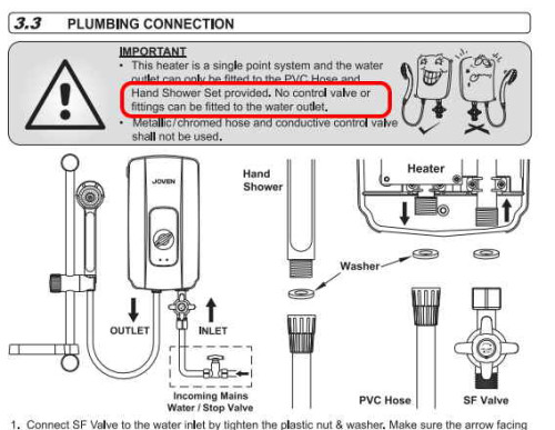

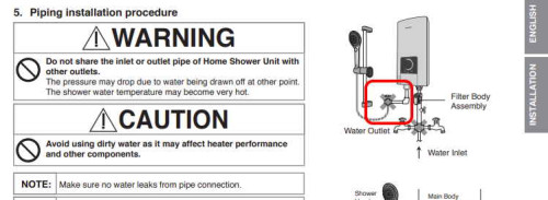

Just be informed that an instant water heater (the usual wall mounted kind) cannot have a tap or shut-off valve or any type of restriction at the hot water outlet pipe.

QUOTE(stormer.lyn @ Jun 5 2022, 10:09 AM)
Isnt instant water heater works only when the water is flowing through ?

QUOTE(mini orchard @ Jun 5 2022, 10:53 AM)
Rinnai
Panasonic
Joven
It's a free country, you can install anything as you like, don't let me stop you
