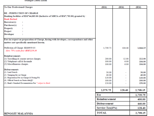

RM820k property, quoted around RM24k total for MOT + legal fees + perfection of charge
Got some discounts as this was a purchase from developer during construction phase.

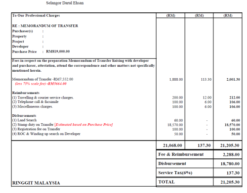

https://www.propertyguru.com.my/property-gu...nsfer-mot-15910
above linked is quite comprehensive
2 main part :
A: LEgal fee
There is legal fees which lawyer quote you to complete the works. - amount is calculated based on SnP price
here quoted as RM 7552.
there is discount... but typically they dont show on quote as not suppose to give legally
as i can see they give very high discount- may be appointed by the property MO
B-MOT
this is paid to government. (LHDN)
via land office
here again calculated on the table.
no discount, non negotiable.
then others are misc loh
in short- you got good deal.
