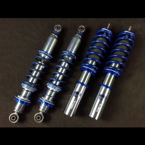

Hi sifus2, been browsing for adjustable suspension for my ride recently, came across with HWL brand series of ST1 and MT1BS.
besides ST1 (15 steps) vs MT1BS (24 steps), is there any other differences between these 2 series in terms of long lasting/QC or build materials etc? HWL MT1BS HWL ST1 ![]() This post has been edited by djandrew: Apr 18 2022, 11:07 PM |

Blistien b8 and eibach springs This is best budget combo compare to these hi lo soft hard crap. U tweak until u also pening. I hate something that you adjust to your liking coz you will always be kacauing it until cannot sleep torreto, constant_weight, and 2 others liked this post

spring rate? bound rebound rate? preload ? step vs step is not important anyway RalphRatedR liked this post

QUOTE(ktek @ Apr 19 2022, 07:26 AM) The MT1BS spring rate front is 6k / back is 4kthe other one ST1 still finding btw for myvi ride is it best front 5k and back 3k overall comfort? This post has been edited by djandrew: Apr 19 2022, 09:27 AM |

adjustable u put paling soft. pun tak comfort ady. djandrew liked this post

QUOTE(djandrew @ Apr 19 2022, 09:27 AM) The MT1BS spring rate front is 6k / back is 4k you want comfort you stay stock suspension only, or go for better absorber with digressive damping so it can slightly improve handling toothe other one ST1 still finding btw for myvi ride is it best front 5k and back 3k overall comfort? front wheel drive car shouldn't use front stiff rear soft setup, maybe for comfort but definitely not for handling i dont know how many owners from car group took out their adjustable the next day they install because it is too stiff spring rate should be customizable, you should be able contact them and let them know your preferred spring rate another important thing that most of the owner doesn't ask is what kind of damping curve that the absorber using, is it linear, progressive or digressive? This post has been edited by amduser: Apr 20 2022, 10:35 PM babisotong, djandrew, and 2 others liked this post

QUOTE(amduser @ Apr 20 2022, 10:32 PM) you want comfort you stay stock suspension only, or go for better absorber with digressive damping so it can slightly improve handling too Doesn't help when 9 out of 10 adjustables are not tuned properly from the first place and meant to compete on prices only. All adjustables do is just put super stiff spring without taking into account of frequencies and damping valvingfront wheel drive car shouldn't use front stiff rear soft setup, maybe for comfort but definitely not for handling i dont know how many owners from car group took out their adjustable the next day they install because it is too stiff spring rate should be customizable, you should be able contact them and let them know your preferred spring rate another important thing that most of the owner doesn't ask is what kind of damping curve that the absorber using, is it linear, progressive or digressive? RalphRatedR, Quazacolt, and 1 other liked this post

QUOTE(djandrew @ Apr 18 2022, 11:04 PM) Hi sifus2, been browsing for adjustable suspension for my ride recently, came across with HWL brand series of ST1 and MT1BS. Damping wise, unsure.besides ST1 (15 steps) vs MT1BS (24 steps), is there any other differences between these 2 series in terms of long lasting/QC or build materials etc? HWL MT1BS HWL ST1 ![]() Difference is the steps. QUOTE(djandrew @ Apr 19 2022, 09:27 AM) The MT1BS spring rate front is 6k / back is 4k HWL problem is rear need to cut the rear bumpstop.the other one ST1 still finding btw for myvi ride is it best front 5k and back 3k overall comfort? So beware. If not you will hit the bumpstop too early and feel bumpy. I find the ST1 lightly firm but with my driving style, I can easily bottom it out. My friend was using ST1, even after I help setup still bumpy at the rear. In the end change to Ftuned CLS + Proride sports absorber. djandrew liked this post

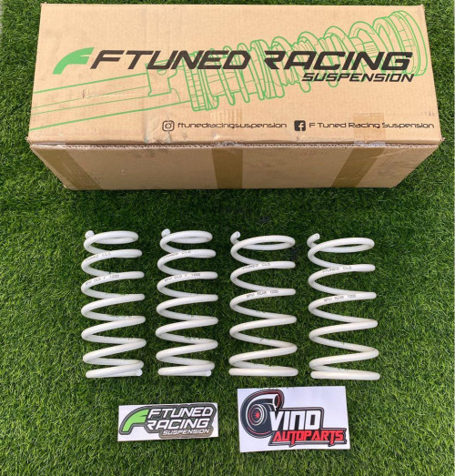

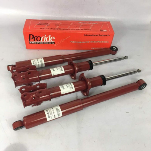

QUOTE(bo093 @ Apr 21 2022, 12:38 AM) Damping wise, unsure. thx for the sharing!Difference is the steps. HWL problem is rear need to cut the rear bumpstop. So beware. If not you will hit the bumpstop too early and feel bumpy. I find the ST1 lightly firm but with my driving style, I can easily bottom it out. My friend was using ST1, even after I help setup still bumpy at the rear. In the end change to Ftuned CLS + Proride sports absorber. im holding back my horses already hahahaa by the way hows ur friend comment about the Ftuned CLS + proride sports absorber? combination of both below pictures right? proride absorber / Ftuned CLS spring ![]() This post has been edited by djandrew: Apr 21 2022, 09:44 PM |

QUOTE(djandrew @ Apr 21 2022, 09:28 PM) thx for the sharing! This proride sports absorberim holding back my horses already hahahaa by the way hows ur friend comment about the Ftuned CLS + proride sports absorber? combination of both below pictures right? proride absorber / Ftuned CLS spring ![]() ![]() This feels more comfortable than the HWL ST1. As I had to installed it for my friend. djandrew liked this post
