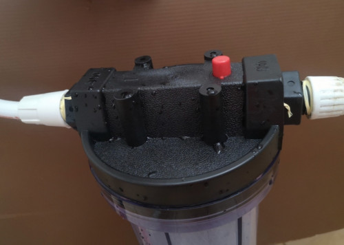

WHAT U NEED TO BUY
FILTER HOUSING x 1 rm25
carbon block filter x 1 rm20
Niple Pipe Connector 1 to 1/2 inch x 2 rm2 ( if u not sure about the size can walk in any hardware store buy them )
WATER PIPE WHITE P.T.F.E. SEAL TAPE x 1 rm0.80
Extra Shower Hose Pipe Hose x 1 rm 14-16
cost u around RM60-70 way more effective than those shower filter out there just kinda bulky & ugly
Best for people that wanna solve the chlorine problem in shower temporary
