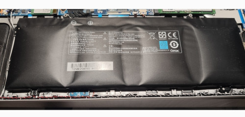

Is there a laptop where the original battery will not expand after say 3 of 4 years of use which will require a new battery replacement? As much as I love my HP Elitebook, the battery cannot last long, average 2 years before it expands causing the keypad to bulge and come up a bit. I have replaced the battery twice already and it's happening for the 3rd time.

So far my Asus ROG and another HP laptop no issue. Had the same experience with shitty Illegear, 3rd year using experience battery bulging, replace battery, +-2 years later same shit. Removed the battery, let it run perma on ac adapter ok.
Took out the battery, let it sit, over time can see bulging more and more..then throw at e-waste collection centre before it explodes.

Heat is the primary enemy of the battery itself.
When you run your laptop under high or full load most of times, then the heat is the primary cause of early battery failure (bulging, lesser capacity, etc.).
Get a laptop cooler pad. The battery will last much much longer. Avoid rapid charge-discharge cycle. The lesser the charge cycles, the longer the battery will last. Modern laptop battery and the charging circuity has cut-off feature when fully charged. From my experience of using various makes of laptops, the heat is the primary cause of failure other than poor/random battery quality (even for big brands).
Even the few gaming laptops that I had for several years, the battery is still in excellent/good condition. If yours is a gaming laptop which usually has a dGPU then a good cooler pad is a MUST! Don't keep the laptop CPU/GPU at over 70% load at long duration. Otherwise, get a desktop unit which has much better cooling/airflow capacity.

My guess is that it's related to battery tech too
Some laptops use Li-Ion cells in bulky hard pack for battery, some use Li-Po batteries (like phones) which are one flat pack that tends to swell

Built in battery get bloated easily.
Previously can take out easier to change without damaging TouchPad and back case.
I have two HP laptops bloated as both using the same same battery model as HT03XL. Thinking to change but afraid not good later.
Avoid HP if don't wanna bloated battery.

As long as li-ion/li-pol cells are used in the battery, it'll susceptible to bulging/swelling due to the gas generation everytime the cell undergoes discharge/charge.
Unless other type of battery cell technology is used OR the mechanical engineer undercalculated the bulging space inside the laptop.
