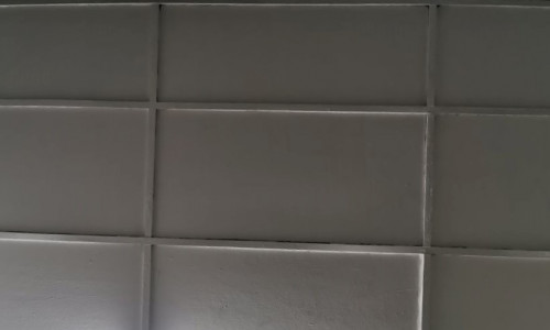

Guys.
My contractor say I can make plaster ceiling directly under my ceiling, screw the board under my ceiling directly and plaster it.
Should I do this way? is it good practice?
https://pictr.com/images/2022/04/11/Bc2plV.md.jpg

Common practice. Don't need to remove the old ceiling.
Imagine the dirt and dust that will fall out if you removed the old ceiling...

he mean no need add new steel, just use the wood beam as steel

QUOTE(milkyboy @ Apr 11 2022, 08:04 PM)
Guys.
<a href='https://pictr.com/images/2022/04/11/Bc2plV.md.jpg' target='_blank'>https://pictr.com/images/2022/04/11/Bc2plV.md.jpg </a>
1. Ease of installation.
2. Slightly lower ceiling height.
3. Any roof or piping leak will not be noticeable immediately.

Hi, can directly screw under the wood beam? instead of adding new steel. My contract idea is to do like this.

If current wood beam strong probably can do it. But my case they still add steel, not really thick but can hold the plaster.

That was asbestos sheet in the photo. Common practice, as no need to spend extra money for removal, clean up, and steel frame. Just directly screw on the existing beam/lease.

QUOTE(milkyboy @ Apr 11 2022, 09:24 PM)
Any new steel will be screwed to the beam ... so no different screwing the plaster to the beam.
Unless you want specifically screwing the plaster to the steel, then the ceiling height will be another 1 foot lower. Then there will be another vacuum space between the new plaster and the old ceiling.
Double layer ceiling will be have better insulation from roof heat.

I think will do double layer, 550 feet, rm3.2k, include painting ok?

QUOTE(milkyboy @ Apr 12 2022, 12:11 PM)
Not sure of current pricing.
In another property which I bought subsale, the previous owner did a double layer ceiling. If you have a high ceiling, lowering it is good as it can cool the place quicker if you have an AC.

I did that with my current place. So far no issues and save abit in cost.

double layer and single layer rm270 diff, so I take double layer
