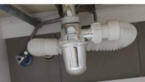

Thanks to my reno contractor, I have this flexible hose under the sink that slow down the water flowing.
Anyone has better idea/contact that can fix this with a real pipe system to avoid any issue that might happen? Thanks

Is the hose the cause of slow flow? Diameter seems to be bigger then standard pipes.

QUOTE(kimteck @ Apr 5 2022, 06:51 PM)
Easy DIY with elbows, straight pipe, pvc pipe glue and cutter/saw.
QUOTE(ran_deep @ Apr 5 2022, 07:38 PM)
The water flow is not smooth.

You can call an experience plumber to fix it for you arounf RM 120 - 150

Yeah, a couple of elbows and straight pipes with some PVC glue will settle it. Or get a plumber, it's not that expensive.
Incidentally, that white corrugated pipe will retain some of the dirty stuff that flows down, so prepare for smell and gunk...

Don't use the flexible hose, it will leaks easily. Change to PVC pipes.

Flexible hose will collect grime and eventually burst/crack
those hoses are for draining washing machine water, not sink
change to PVC pipe
