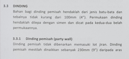

Hi,
Aside from the wall should not exceed 5feet (height).
Are there any guidelines for the design of wall between your house and neighbour's house in shah alam ? Like there needs to be x-openings in the wall, size of opening, etc....

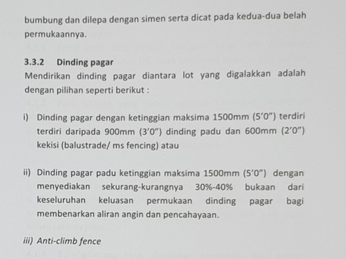

I saw these guidelines (below). From what I understand, I need openings (30-40%) for the walls. Correct ?

QUOTE(jex-koi @ Mar 2 2022, 11:32 AM)
If you drive around those taman under mbsa, you notice many also no opening.
So is up to you.
Most important, agreed with the neighbours whatever the design.
If worried, do round 2 after the major work completed.
But all bricks will have minimum issues with neighbours in future.
Need that 30-40% voids otherwise the house hall will become very warm.
Alternatively you can also do the BRC fence.. low maintenance https://www.lazada.com.my/products/brc-fenc...6884884271.html
Because one problem with brickwalls and rain it will look like crap after mould sets in on it. If you're free to jet wash and repaint every couple years then ok lah.
Brickwall you lose more usable space as compared to compact BRC fencing. BRC one is galvanised like streetlamp = less maintenance to do
