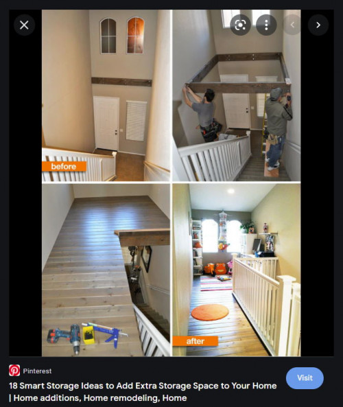

stormer.lyn
post Feb 19 2022, 08:17 AM
1,132 posts
Joined: Apr 2014
From: Shah Alam, Selangor
QUOTE(miyakochan89 @ Feb 18 2022, 08:57 AM)
I am thinking to mount a ceiling fan. Last time a contractor told me that there's a huge space between my ceiling and the penthouse above. A space enough for a grown adult man to stand and walk without needing to hunch.
This strikes me as strange. In a condo, where space is a premium, there is such a large unused space? As the developer, I would have integrated that space into the penthouse above, and charged a premium since the floor space for the unit above is larger. I urge you to double check what your contractor has told you.
Maybe what the contractor said is true exactly above the place you want to mount the fan, but the entire space is only 2 m wide. (just speculating on the possibility) In that case you only need a wood support piece that is 2 m long, as you can mount it wall-to-wall instead of top-to-bottom.
A suggestion - since you are going to redo the plaster ceiling, why not see if you can make it into usable space? I see lots of people making a "mezzanine" of sorts in their house above the staircase to regain some usable space. You could do something similar if the space is as big as the contractor has said.
(Image from Pinterest)
TSmiyakochan89
post Feb 19 2022, 11:04 AM
Wut?
6,724 posts
Joined: Aug 2008
QUOTE(stormer.lyn @ Feb 19 2022, 08:17 AM)
Yes there’s a large space between my unit and the penthouse because each of the penthouses here have private swimming pools in their own units. So they need to accommodate that depth of the pool.
And I don’t think you can just make use of the space like that, it’s a condo after all. Not landed property.
This post has been edited by miyakochan89: Feb 19 2022, 11:06 AM
