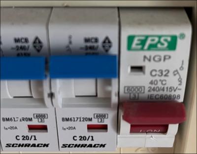

any possible reason that the fuse will be malfunctioned?
when i mentioned malfunction, means the smart meter digital reading also no display..
so the quick solution was to replace the fuse, then it works again..
could be overloaded? why say so, coz what i noticed was, i was using below at same time:
- dryer
- vacuuming floor/dust
- ac 2.5hp
- ac 1.0hp x2unit
- other basic devices no need to mention: tv, fridge, fan, etcs..
and out of sudden tnb meter no display.. neighbors were fine

TSspreeeee
post Feb 14 2022, 12:09 PM
3,812 posts
Joined: Apr 2009
From: West Malaysia
QUOTE(Zot @ Feb 14 2022, 11:46 AM)
As you can see the switch in your DB is 63A which means the single phase current is limited to 63A for a house with single phase. The fuse supplied for my house was 35A (if not mistaken, I forgotten already). Some house the contractor gave 60A fuse. Mine cheating I guessed  biggrin.gif
One day when I was back home from work my house has no power. Luckily there was still one electrical shop that was still opened at almost 7pm that day. So, I bought a replacement fuse rated at 63A (or can use 60A). The TNB website said an online application is good for 60kW application or 100A.
Don't simply use any wire and assume same wire thickness will carry max power the same as the blown fuse as permanent replacement. The wire rating is not by size or diameter only but also the material.
the photo on 1st post was just a sample from googleimage.. lol..
i think my smart meter is 100A, it clearly written there as attached.
so should be safe to change to 100A fuse?
if yes, well.. tnb should also change the fuse when they change new smart meter..

QUOTE(Zot @ Feb 14 2022, 12:21 PM)
The meter is 100A because that probably the limit TNB set for a single phase line. Most important is to look at your circuit breaker and the main switch in distributor box (DB). I bt the switch and the main circuit breaker is 63A rated. So, stick to the rating.  smile.gif

QUOTE(spreeeee @ Feb 14 2022, 01:57 PM)
Your incoming MCB is located at the Distribution Box(DB).Open up the DB box, see what is the main incoming MCB rating.
The more accurate way, get the meter clamp, clamp the single phase cable, see what is the running ampere & compare it against the rating of fuse when you are operating all the devices together. If the ampere reading at the clamp meter is close to the fuse rating, it is obvious overloaded.
If overloaded, the only solution will be upgrading your incoming to the 3 phase. By upgrading, the TNB will upgrade the incoming cable size, the metering panel from single phase to 3 phases, the fuse will be upgraded. On the owner side, your DB need to be upgraded to 3 phase also.
TSspreeeee
post Feb 14 2022, 02:15 PM
3,812 posts
Joined: Apr 2009
From: West Malaysia
so it is 35a, or 63a?
COOLPINK
post Feb 14 2022, 02:19 PM
3,663 posts
Joined: Oct 2010
QUOTE(spreeeee @ Feb 14 2022, 02:15 PM)
looks like 32A.
nihility
post Feb 14 2022, 02:29 PM
1,595 posts
Joined: Sep 2021
32A SPN. This device was not tripping, get the electrician to check the functionality also.
With 32A SPN, max you can use concurrently should be limited to around 6kW only. It was overloaded.
