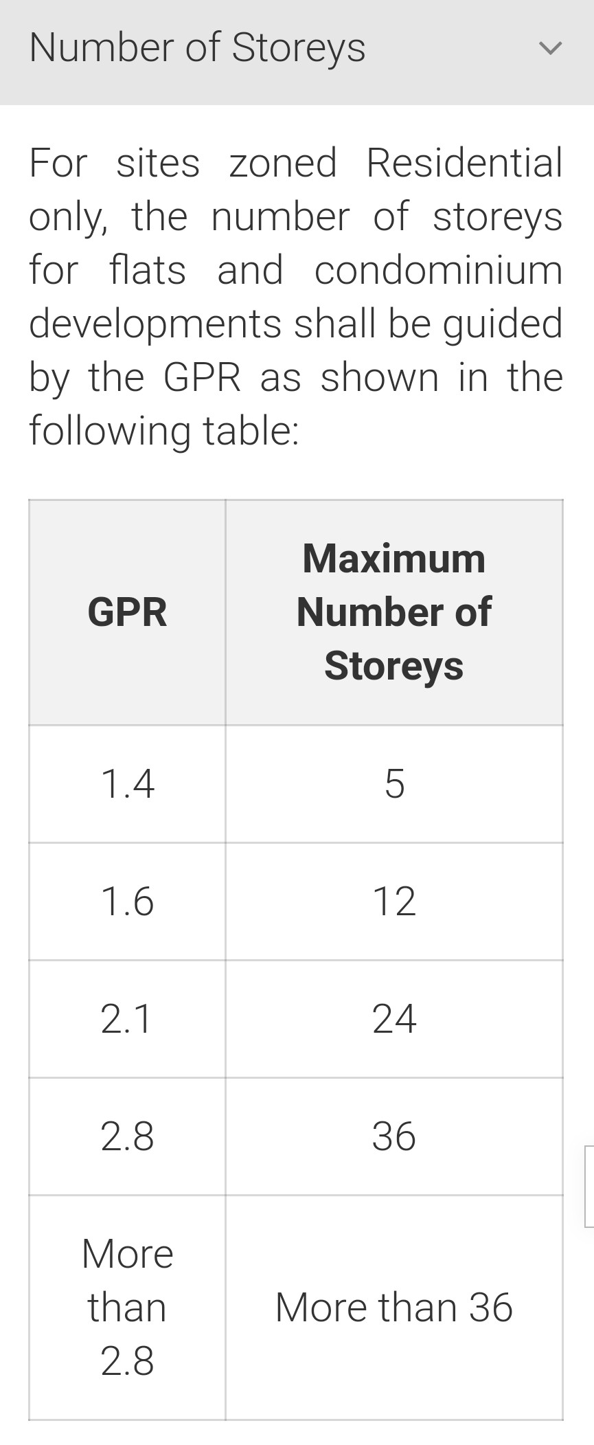

Actually that's incorrect, not sure where you got the idea that 1:4 is a hard cap for residential
under URA master plan (as of 2021), 1:4 is on the "lowest density" side
Singapore can go all the way up to 2:8 or higher, they do however limit the number of stories (for safety reasons, as their land is not suitable for multiple skyscrapers)
Note that this is for residential use land.
KL's cap of 1:10 and their subsequent implementation of capping the maximum number of storeys was done in mid 2019, so it's a recent development. Before that it was higher. Mega projects with higher plot ratios that were approved earlier had to get special approval.

I didn’t mean 1.4. I meant 4 gpr as in the Singaporean table you linked. They changed the way they accord ratio.
Just for the sake of semantics, take away the 1:
Edit: ok I get it now, if it’s pure residential ie condo then it’s 4 plot ratio max. If it’s commercial ie. serviced apartment then it’s 10. Aren’t developers just converting the title anyway to commercial? It’s the dominant high rise type nowadays. I don’t believe the concept of commercial under HDA was a thing more than 10 years ago.
