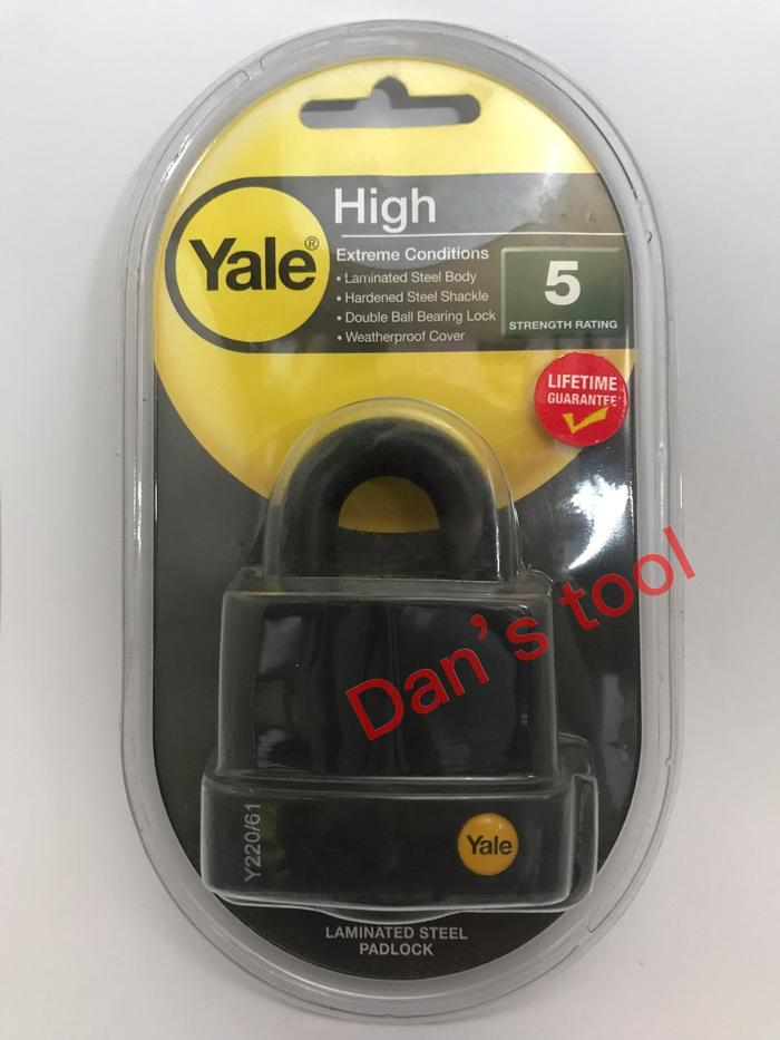

hi, anyone can recommend padlock lubricant? need to service some of my old yale padlock soon. "Not looking at WD40 multipurpose" ahem u know how it works... biggrin.gif

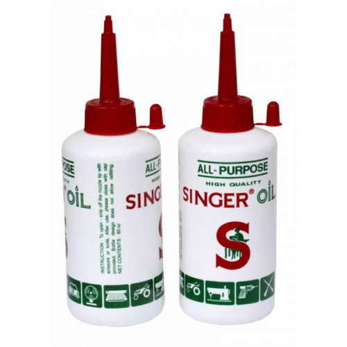

singer sewing machine oil

yale padlock? spring type err?

Depending on who/where/what you read, you are not supposed to use oil-based lubricants at all.
Because it gunks up the mechanism inside.
You are supposed to use graphite powder.
But I use light oil (Singer). No complaints.

From: Ipoh/Penang/PJ/Melaka
Alternative.. singer oil.. very cheap.
