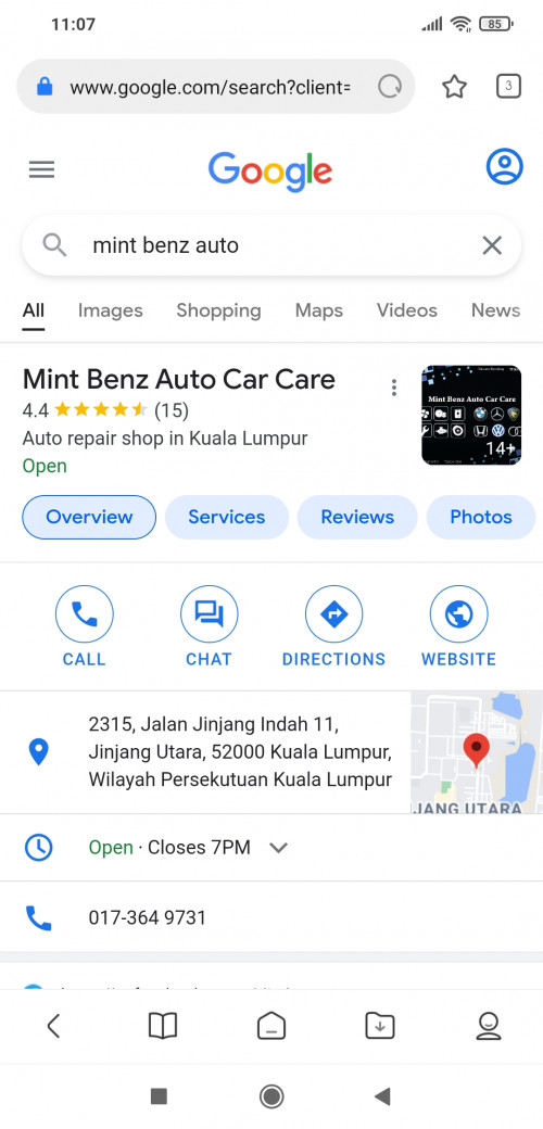

You can try here this shop with proper equipment available like electronic diagnose etc
