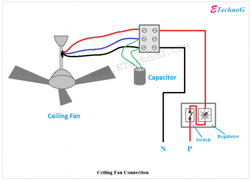

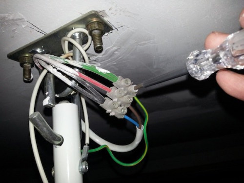

Remote controlled 3 speed fans were prone to nonlinear or no speed regulation.
There's a good cheap way to solve it by bypassing the remote control and speed regulator board inside the fan.
You need to know how to read the diagrams, how to locate the wires and have the hand skills to rewire the fan.
Remove and bypass the wiring of the speed controller in the remote controlled fan
Wire the fan with wall regulator

QUOTE(JimbeamofNRT @ Jan 20 2022, 09:36 AM)
which model is this? can add on regulator?
mine control via wifi. 10 speed
See proposal above

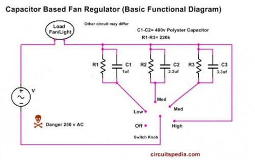

Zot
post Jan 20 2022, 10:32 AM
7,938 posts
Joined: Mar 2014
It is usually one of the big capacitors went bad. Even if you don't know which one, just change all of them and still way cheaper than get it repaired outside. You probably need soldering skill though.
Those capacitors are common and easily available and make sure you replace same type, not just value.

Zot
post Jan 20 2022, 11:15 AM
7,938 posts
Joined: Mar 2014
QUOTE(New Klang @ Jan 20 2022, 11:08 AM)
Where to buy decent capacitors?
Any electronic shop will do like in Pasar road. Normally polyester type used (non-polarized). Shop will know usually. Each one is not even RM10. Probably RM4~5?
All 3 capacitor regulate speed but normally one faulty. Can buy multi-meter that can measure capacitance. China brand cheap. Even Fluke for China market is sold here and very cheap compare to international version.

How to OC? highest speed is without filter, see diagram 1

QUOTE(Brotherjoe @ Jan 20 2022, 11:29 AM)
Put a higher capacitor, the fan will spin a lot faster.
Yes, the higher the Cap, the smoother the current. More on time than off time

QUOTE(abhipraaya @ Jan 20 2022, 11:29 AM)
I bought it from shopee. if I recall it was 4 yellow and 1 black capacitor. Less than RM20 for all of them.
Just use the correct rating capacitor matching your old one, plus minus - a very small deviation is OK.
Too high then ur fan will spin too fast and reduce lifespan of the motor.

Why your fan got red, blue and black wire ah? My fan only got 2 wire for power, and green Earthing wire,

QUOTE(stormer.lyn @ Jan 20 2022, 11:38 AM)
This one was copied from internet
The correct one is below, only 2 wires
