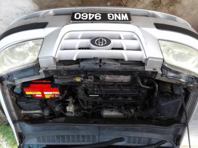

Thank you y'all for your answers. I will surely forward them to her. There's no doubt that she loves the Matrix, but yeah you guys are most probably right changing to a trustworthy mechanic, ought to resolve her Matrix's never ending issues.
Attached is a picture of the front of her Matrix that I have. You guys probably will know better which model, etc etc. I know nuts.
Initially I informed her to get an original alternator although the price quoted by Hyundai Authrized Service Center was rather high, but since her Matrix was stranded on the roadside, after running down the new Century Battery completely for 3 days with a failed alternator. Mostly probably the car was not driven for 2 days and when she droved it on the 3rd day after some distance, the battery was drained completely.
I informed her of the failing alternator after installing the new battery but she thought nothing of it. Since she was stranded, so she called a nearest mechanic available at that time.
I will retest her alternator in due course and if it is still not satisfactory, she will be introduced to my contact to have the problem in the alternator replaced.. Or she could decide to go with an original new unit from the Service Center, if she still wants to keep her beloved Matrix after reading y'all comments.
What I really like about this Malay lady was after installing a new battery, she claimed the car was like a different car altogether. It had more power, it could overtake etc etc without being sluggish etc. You guys probably wondering how come ? That's because previous installers were putting in an under spec battery.
Being a single and without car knowledge, I am sure the workshops are taking full advantage of her lack of knowledge. When I observed what was being done at the workshop, I too wasn't happy because they were painting my Principal Co. product in a very bad light due to their underhand tactics. That leads me to believe there are conflict of interest. Now which is more beneficial for a new battery replacement, from a distributor or from a workshop ? 😉
PS : I am really sorry for the upside down picture. Strange on my phone the picture was upright, post je terus terbalik !!! 😵
