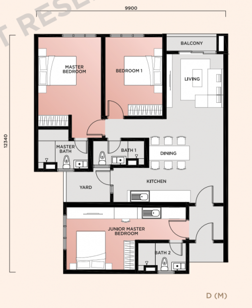

 1216sqft 3 room house reno 50k or 30k
SUSmrlive005
post Jan 6 2022, 04:46 AM, updated 4y ago
114 posts
Joined: Nov 2013
Im totally clueless regarding renovation cost and current trend of renovation type, bought a new house and the completion date is estimated at Q2/Q3 2023
i read plenty of topic and saw pros recommend stuff, but i couldnt get enough of what i should do
basically i want to reno (the house came empty, standard condo)
-kitchen
-living hall ceiling
-2 room with wardrobe with bed
i have 1 year+ to save some more money to get enough exclude appliances, i'd appreciate if there is some photo or the names of material to reno
i'll go with either one of this budget for my new house renovation cost
RM 50K
RM 30K
If its were you, what will you reno to this house?
Appreciate for help out.

The first thing is to list down .....
1. Must Have
2. Optional
Then go into each item with estimate budget and how you want the job to be done ... one main person or few persons from different suppliers.

If you have tight budget, please write down your wishlist for something that cannot be done after move in.
Spend money into these items first.
For examples:
* Plaster ceiling
* Concealed wiring / power points
* Pipe relocation
* New wall / partition
* Tiling/Flooring works
* Concealed aircon pipe (if not available)

This is a dual key unit. Depending on if you are going to use it as an investment and fully furnish the studio to be self sufficient with stove, fridge etc. I’d err on the higher side of the budget but mainly to make sure it’s completely move in ready rather than pretty. If it’s home use then entirely up to you.

Kitchen kabinet/sink/gas n hood
Plaster ceiling/lighting
Build in kabinet

1. Check out the requirement of main wiring ,light point, fan point, switch point /power point .
2. Kitchen cabinet , any good location for sink, fridge, hood and hob /ducting etc.
3. Any plumbing required to place sink/ washing machine
4. check if grille is needed and follow management std.
5. check if repainting is required
6. Wardrobe will be the last to be considered (melamine is the cheapest), as it's easy to install, unless you need led light on wardrobe, (same goes with kitchen cabinet)
If no plaster ceiling/ rewiring, or wet work included, 30-50 k should be sufficient. Or the condo is well designed with all those, can just buy furniture/appliance and move in, save your money.
