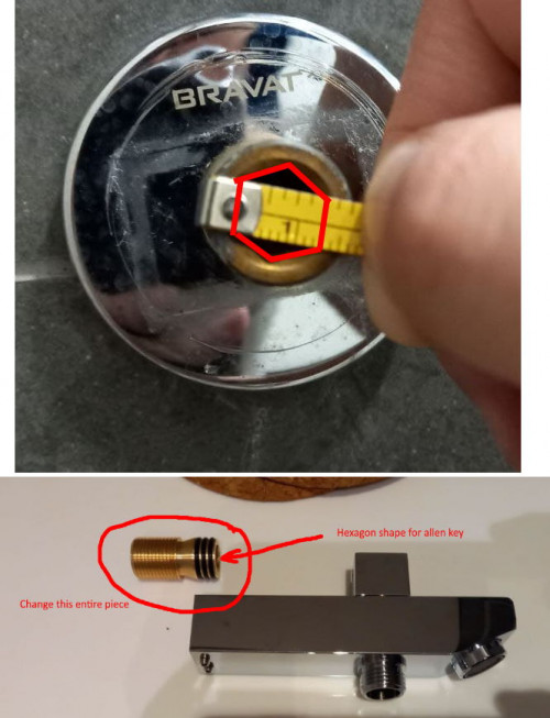

Remove the entire old fixture from the wall, and use the brass fixture from the new fitting. The "Bravat" (old) brass piece has the hexagon shape because it can be removed with an Allen key.

it should go ontop like this highlighted in red right?
QUOTE(stormer.lyn @ Dec 29 2021, 09:44 PM)
I tried looking around it but cant find a screwpoint for the allen key

QUOTE(bobohead1988 @ Feb 1 2022, 04:16 PM)
It is a very large allen key. If you don't have an allen key, find a bolt that fits, and then grip the bolt (thread part) with vice grips to tighten the brass part of the tap to the pipe in the wall.
