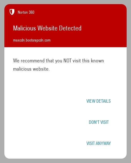

QUOTE(AAY @ Dec 24 2021, 11:03 PM)
maxcdn.bootsrapcdn.com
if, and if, you REALLY mean maxcdn.bootsrapcdn.com, then they probably got major hijack until ISP had to step in to protect large number of users.
This post has been edited by Oltromen Ripot: Dec 25 2021, 10:28 AM

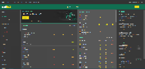

Huh, so maybe City Broadband doesn't honour MCMC's block list? Are you able to get a response back for sites that are definitely banned such as bet365<dot>com?
Cincai.La
post Dec 25 2021, 09:03 PM
184 posts
Joined: Jun 2020
From: IPOH
QUOTE(AAY @ Dec 25 2021, 03:13 PM)
Can get response.
