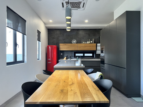

It's for those who do not mind spending money when necessary to replace, in exchange of a minimalist clean look of the kitchen. But if boring is what you are worried, you can always opt for colored fridge. My fridge is what stands out when friends comes visiting.

QUOTE(McFD2R @ Dec 27 2021, 12:43 PM)
Sleek looking kitchen
