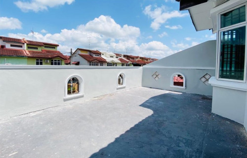

Hi everyone,
I am new here (first post!), and hope to gather your experiences on this matter.
I am wondering if a portable swimming pool like below (3mx2m, about 3500kg) may be too heavy for a terraced balcony on the 2nd floor (also shown below). I worry the balcony/house collapse on me rclxub.gif ... so any way to confirm if supportable?
Cannot post any links/photos yet... as I am still under probation...
Any comments/advices welcome!
Thank you in advance!

An example of the balcony
https://pictr.com/images/2021/12/17/BYVgBu.md.jpg

Devil_Red
post Dec 17 2021, 03:44 PM
8 posts
Joined: Apr 2011
Unless you have the structural drawings (whether it's original or reno extension) , and ask a structural engineer to counter-check it, there is no other way you could know.
3.3~3.5tonne isn't a joke. Image you equivalent to says 3 Honda City Weight.
