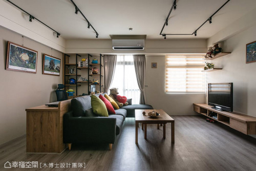

Hi all,
I am planning my new house and thinking of not doing plaster ceiling but wondering how should the wiring (light, fan aircon etc) being kept.
Have done some searching in Google image and see some ideas but not sure how realistic it is.
Is there anyone here can share some real sample and experience?
Below is one of the photos found in Google image:

if you dont have ceiling fan, then is easy. hide all wiring, ducting on one side.
https://renopedia.sg/5-ideas-of-ceiling-des...re-captivating/
advantage = your room feel higher = airier
disadvantage = if ceiling not flat/lousy plastering, it will show.

QUOTE(fireballs @ Dec 2 2021, 10:04 PM)
Wow this is a good idea but not sure about the overall brightness if do only one side.
Thanks for sharing!

QUOTE(twjjack @ Dec 3 2021, 01:52 PM)
Thanks for sharing!
Then put box up. It's relatively low cost compare to full plaster.
Drawback is, the box up collect dust easily.
