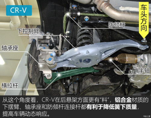

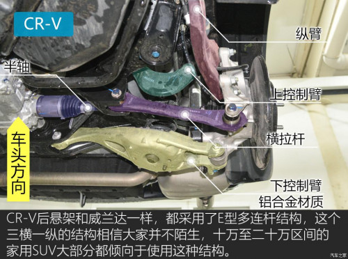

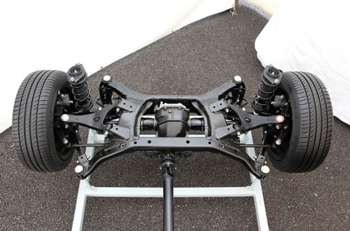

the toyota " double wishbone" is actually a e type multilink
which is same as honda multilink
these multilink is diff than luxury car 5 link multilink but still better than torsion beam non the less

QUOTE(heihei @ Oct 23 2021, 06:00 PM)
Lol where you get this info from?
TNGA platform is real double wishbone
No way Honda will use double wishbone. Double wishbone suspension setup is expensive af.

QUOTE(Juggerballz @ Oct 23 2021, 06:04 PM)
marketing tricks works well i see
that's why Usa toyota use the word multilink instead of double wishbone wording as toyota could be sue for misleading brows.gif brows.gif
CRV vs RAV4
similar design , wihout any wishbone can be seen whistling.gif whistling.gif whistling.gif

QUOTE(Juggerballz @ Oct 23 2021, 08:11 PM)
Toyota in USA are different from global design. To fight sales and lower down costs, toyota(s) in USA are designed to be less "fancy".
Evidently you can look at their VWs, macam trash only....
nope the suspension is exactly the same design
no wishbone design but a E type multilink
