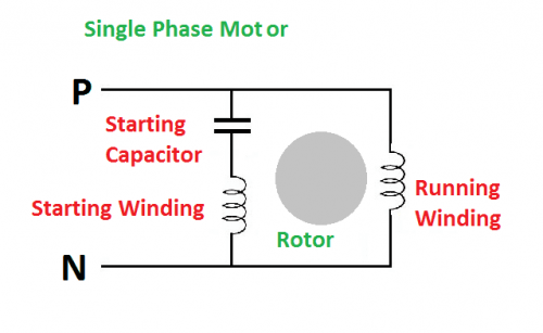

QUOTE(blanket84 @ Oct 19 2021, 05:14 PM)
The capacitor inside the compressor unit that is used to start the compressor.
Why capacitor is required for Single phase motor:
Single phase motors are not a self-starting motor, single phase power supply cannot create rotating magnetic field because of its nature (only one phase). So that to rotate the single phase motor we have to give rotary moment or manual rotation to get continuous rotation. But at that same time we can run the motor but adding extra starting winding and the winding will be connected in series with the capacitor. Technically it is called split phase capacitor method. We are going to use the capacitor property (in capacitor voltage lags the current by 90 deg ). Here the supply voltage will be phase shifted by 90deg. hence by adding capacitor we get the two phase simultaneous from our single phase supply. Hence the motor starts rotating.
