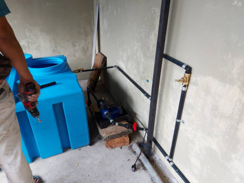

Quick update:
I've installed a tank already with the water pump.
0.5hp works just sufficient for double storey intermediate, can have 3-4 taps simultaneously open and still have sufficient water pressure for normal use.
