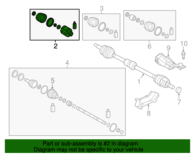

Maybe go ask Hyundai part stockist on this part number 49582-3Y100 for left hand drive shaft, or 49582-3Y150 for right hand drive shaft.
Elantra 1.8 Sedan Inner CV Joint
