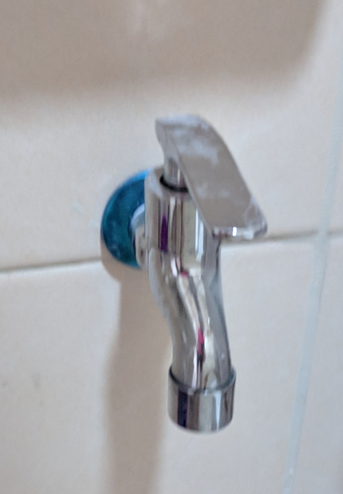

Hi all,
Can washing machine use this kind of tap?
cedyy
post Oct 5 2021, 07:19 PM
1,404 posts
Joined: Jun 2009
Can
matrix88
2,236 posts
Joined: Nov 2007
Yes, no problem.
Just need to install an adaptor to the hose
UnknownH
post Oct 5 2021, 07:21 PM
1,437 posts
Joined: Mar 2009
From: ME TO YOU
With proper adaptor, what tap also can.
haturaya
post Oct 5 2021, 07:40 PM
Elite
2,559 posts
QUOTE(shinchan99 @ Oct 5 2021, 07:15 PM)
Hi all,
Small matter, just get appropriate adaptor. thumbsup.gif Any hardware shop can help you. Just show tap photo and washing machine hose ends. They'll know which one is right.
SUSceo684
post Oct 5 2021, 07:42 PM
Component Burner
11,667 posts
From: Klang/Subang
Can, but it may be safer to extend 6in hose with hose clip to the tap, and use those clip on hose adaptor from daiso so you can use the quick release (on the WM inlet hose) without stressing the elbow L joint inside the wall (leak already u need to hack to fix)
mini orchard
post Oct 5 2021, 07:43 PM
10k Club
14,511 posts
Joined: Sep 2017
COOLPINK
post Oct 5 2021, 07:48 PM
3,666 posts
Joined: Oct 2010
More versatile if you get a quick release adapter so you can use the tap other than fixed to washing machine.
taitianhin
post Oct 5 2021, 07:50 PM
Look at my STARS, it never burn out
1,523 posts
Joined: Apr 2005
From: too far to see
Hi all,
just unscrew the mouth, and install the Washing Machine pipe with new Mouth
TSshinchan99
post Oct 5 2021, 08:00 PM
619 posts
Joined: Feb 2005
thanks all for the reply..
reason why I use this tap is because I will remove from existing toilet and install it for my washing machine.. I'm replacing my toilet one with bidet spray.. so have extra unit and no need to buy new one for my washing machine
