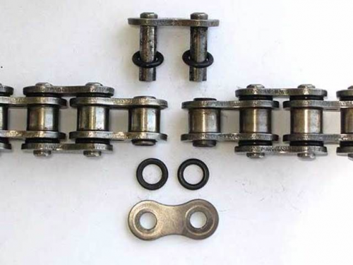

Chain lube - have a look at your chain to determine what type it is.
- Normal chain - shorter life span, cheaper, need oiling more often.
- Sealed chain - Got rubber O-ring or other types (T, W, X, Z, XZ etc). Clean and lube once every 500km is very good.
